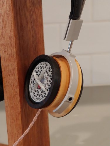

Redid my V9 build with some newer cups I made for myself. Been testing out an all natural, food safe finish made from beeswax and linseed oil. The wood is Rosewood and Maple, laminated together.
Note, I recessed the driver to see how it sounds. Will share impressions as they come.
I also rehoused my V8 in my daily driver cups. These are finished with Shellac and are Ebony, Walnut and Purple Heart laminated together.
Will try to do some side by side comparisons this week, with the V9 recessed and flush with the cup lip.
