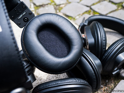

Packaging, Build Quality and Accessories:
The packaging is quite simple, a card box with a picture on the front and info and specs on the back, these do not come with an elaborate fancy box, but again they are studio headphones so no need. Nothing special here, but the box does protect the headphones during shipping.

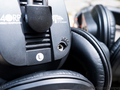

The build quality is great, they feel like they are built to last with solid metal sliders, a metal headband and the use of high quality plastics. The earpads are soft but very flat with a small opening for your ears. They use a locking detachable cable mechanism, which works well and again shows they are made to last. I have no issues with the build quality.
Accessories are not many, all you get in the box is the headphones and 2 cables, 1 long black 3m cable with a 6.3mm jack, another short orange 1.2m cable with 3.5mm jack for portable use. I would have liked to have seen a carry pouch, but not a necessary accessory and for the price I cannot complain, these are all about the sound.

The comfort is not great, the clamping force is manageable but the pads are rather thin, luckily you can change them out. It may alter the sound a little, but will most likely alter the comfort for the better a lot more. I find these fine for short listening sessions, but the padding on the headband is minimal which causes slight irritation after about an hour’s use.
