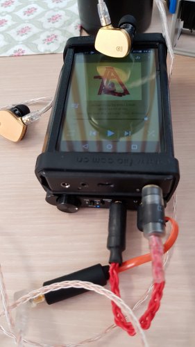

UAPP - X5iii - NX4DSD - Solaris = great combo,
with bass boost: Bass with good layer. High Detail...
additional Ifi earBuddy if the unbalanced (low volume) occured because of NX4DSD, or Noise background come out, nor Simbilance.
best test with Billie Eilish Album dont smile at me. A lot rumble and mid high that can be potential Simbilance.....
edit : Using USB from X5iii to NX4DSD, create significant noise, that is why I choose LO instead.... FYI....

My combo with the best sound is the UAPP-X5 III-NX4DSD(as DAC)-BGVP DMG without Bass Boost. BGVP DMG boldly confuses my high-weighted FiiO FH5. Other world. Even the FiiO X5 Classic through LineOut play a lot more enjoyable, especially bass. massive upgrades. I have no noise - UAPP in X5 III has been set by BitPerfect for USB Output. Perhaps the ears of an elderly man, perhaps UAPP v. 5.0.6
