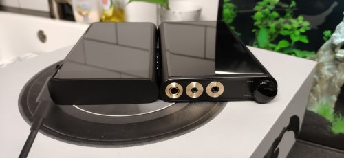

Shanling M6 Vs Fiio M15? I have an M9, planning to upgrade and get more juice to my FH7....thanks...
Just got some in, not had chance to set one up and listen yet but ironically they share the exact same build, shape and dimensions.
The M11Pro Stainless Steel however feels a much more premium device. I won't get chance till tomorrow to take a listen.
IMG_20200127_172002.jpg IMG_20200127_172058.jpg IMG_20200127_172107.jpg IMG_20200127_172128.jpg IMG_20200127_172149.jpg IMG_20200127_172217.jpg IMG_20200127_172236.jpg IMG_20200127_172257.jpg

thanks for the physical comparisson... yes I anticipated these 2 would look very similar, gladly that fiio adopted a more smoth form. one thing I noticed from the pictures is that the M15 has the golden rings around the headphone ports, but apparently this is just marketing gimmick
Wainting to hear a comparisson in other attributes, thanks again....
There will be a golden ring here too but it won't make it sound any better :ksc75smile:
