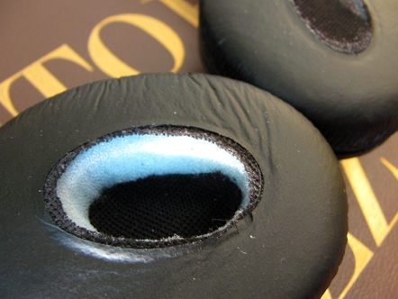

So, after these positive first impression I proceeded with a small mod of their foam pads to make room for my IEMs:
Out of the box the phones have a thick padding made of foam that fills the entire ear pad (left pic - right earpiece). I removed the foam pads and cut out a hole in the center. Then I put the pads back on and inserted the cut out piece of cloth back into the hole to protect the driver from lint. The whole process was pretty easy and using a small pair of scissors took about 10 minutes.
I tried the result with my IEMs underneath and concluded there was enough space to make for a comfortable fit. The ANC25's foam is heat sensitive, so after putting them on you have to wait a few minutes for the foam to soften. Thereby it compresses by about 50% which still leaves enough room for each of the three IEMs I've tested.

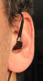

Ok, I was ready to go now! I spent the whole last week switching between the JVC FX700, Final Audio Design 1601SB, Radius DDM while commuting on bus and subway and walking around in traffic and noisy surroundings.
So here are my impressions after a week of field testing:
Fit:
Pretty easy. The FADs were worn downwards because they stay more securely in my ears that way, the others over-ear. After a bit of practice I had no problems putting the ANC25 over my IEMs and get a comfortable fit at first try. One leg of my commuting takes about 45 minutes during which all phones would stay reasonably comfy, except for the FAD's long metal stem getting pressed against my earlobes and calling for a slight repositioning every now and then.

Wearing active noise cancelling headphones over open/vented IEMs has a certain impact on sound quality, because they allow for less air flow and create an outer acoustic chamber around your IEMs. I immediately noticed this resulting in more bass and less airiness and knew I had to try different tips to make up for these changed acoustic parameters. Here's a picture of my normal tip size (left) and the tips I ended up with for the DDMs:
Basically I settled on a very loose seal that would normally kill most of the bass, yet still got enough bass and a pretty balanced sound underneath the ANC headphones. Regrettably I wasn't able to fully compensate for the loss of airiness and maybe also lost a bit of soundstage, but overall the IEM/ANC combo's sound quality was almost like wearing the same IEMs without headphones and certainly better than any similar sized on-ear headphone I've heard.
Btw, obviously you can't change anything about the FAD's metal tips, but these were least affected by the headphones in the first place.

I bought the ANC25 a few months ago. I also cut a driver sized hole in the foam but I did not cut through the cover. I know your review was not concerned with the sound but the ear pad foam mod really improved the mids and treble. The bass was already quite good. I reviewed these on Amazon.

Hey, in that case thanks, it was your review that convinced me that these would be suitable for my purpose! I agree, your mod actually improves the original sound of these phones, even though this wasn't a priority for me. For my purpose I had to cut through the cover, but of course that wouldn't be necessary if you'd just use them as headphones.
