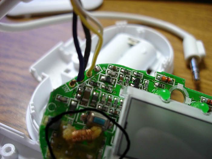

SO I purchased a belkin ipod fm transmitter, the reception was poor and one side of the numbers does not display properly, I open it up to hard wire a thicker ant., and I see this
the the freak is that, and could this poorly made device hurt my ipod?
looks like solidified glue or wax of some type. and its spilled all over the board.

Sorry, but that's a nasty pic, so it's hard to tell. Looks like an RF coil, though.

agreed, a picture with better focus is needed

Not that strange, RF coil with sponge soaked in wax
The cheapest way of restraining the coil once the circuit were aligned
in the factory
Very common in old radios
Sep 8, 2005 at 10:55 PM Post #8 of 9
Yup. The coil is tuned by spreading the turns apart to change the inductance, then held in place with a bit of bee's wax. A technique still used in analog radios circuits by many maufacturers.
