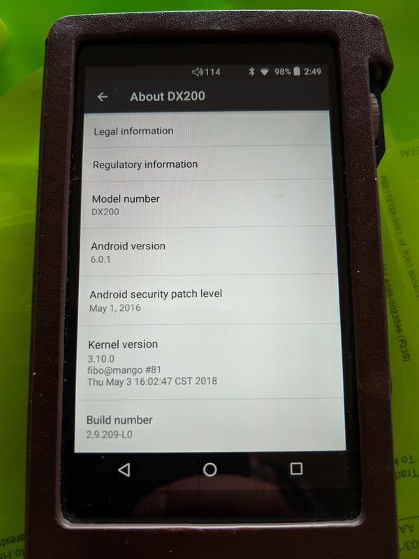

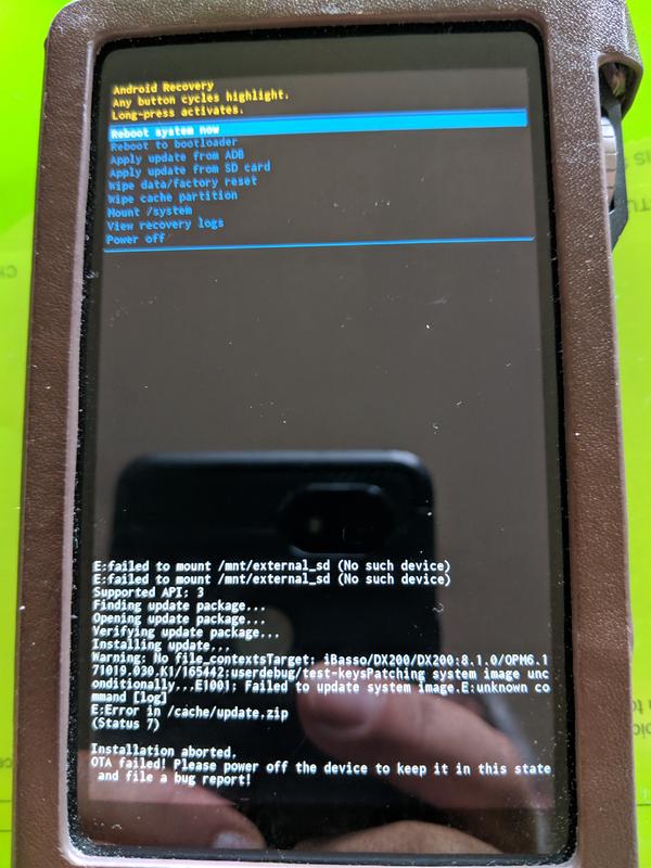

So I tried to update my DX200 with the latest firmware on iBasso's site From a Lurker build of 6.01 to Android O 1.0.5 (see pics for actual screens), and it failed. I tried a smaller 64GB SD card as well and that failed. Looks like it's not seeing the SD card?
Should I install a different build first? Is this a common failure?
To jump from Android 6 to 8 you need to flash this build first http://www.ibasso.com/uploadfiles/download/DX200FW-8.1-V1.01.006.zip but you need to do it with the included Flash Tool from a Windows computer, all instructions and tools are included in the download
