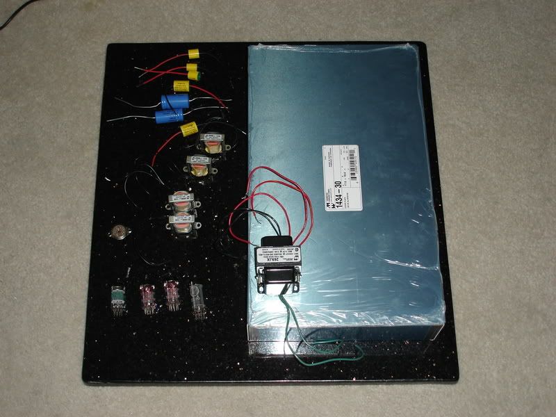

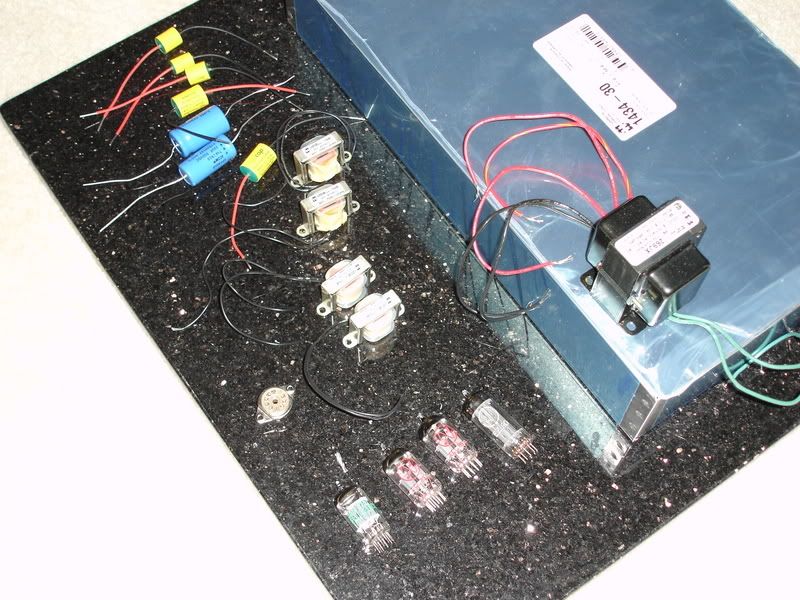

My passive RIAA tube phono stage and the granite that's going to become the top of my turntable stand...fun fun
