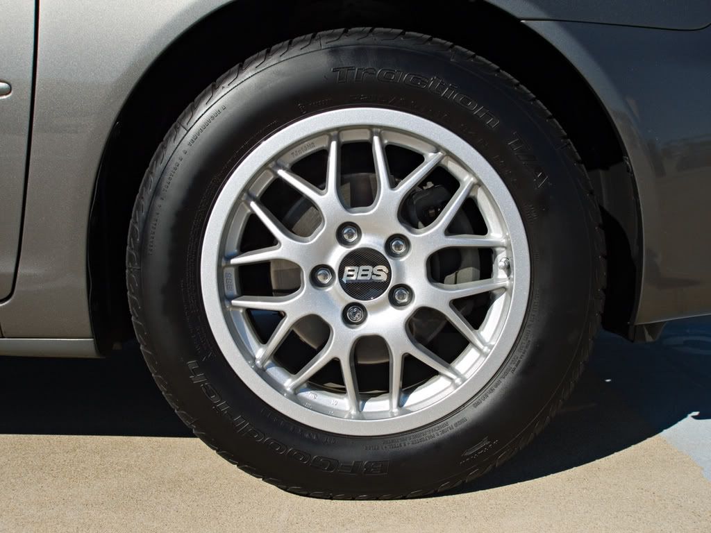

Hey it's not Ferarri... but don't go slaggin' the Camry!
I went with a BBS 16 on mine...
Oct 20, 2007 at 8:54 PM Post #15 of 23
Man, those look fancy.
