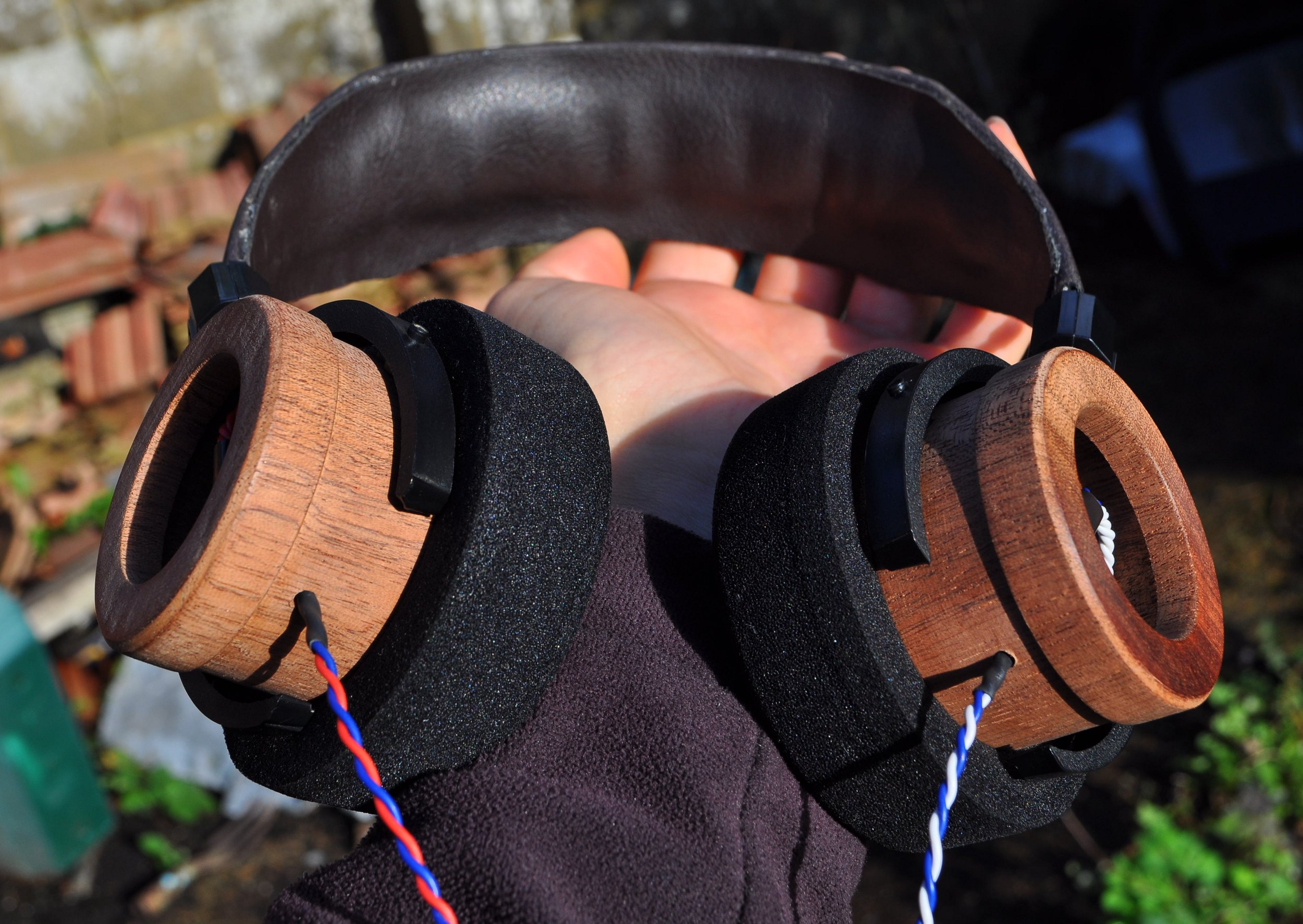

Small update:
Finished turning the second cup, and trimmed it down to make sure that the dimension are ok to allow for Grado pads to fit.
Had to cut it by hand since my lathe/chisel wasn't up to the task, still need to sand it down a bit, although most of that will be bored away in the end.
Sep 7, 2012 at 6:23 PM Post #15 of 128
Took these with my tablet immediately after finishing with the second one, it was noticably browner to start with and has faded (if that's the right word) to that reddish purple since.
