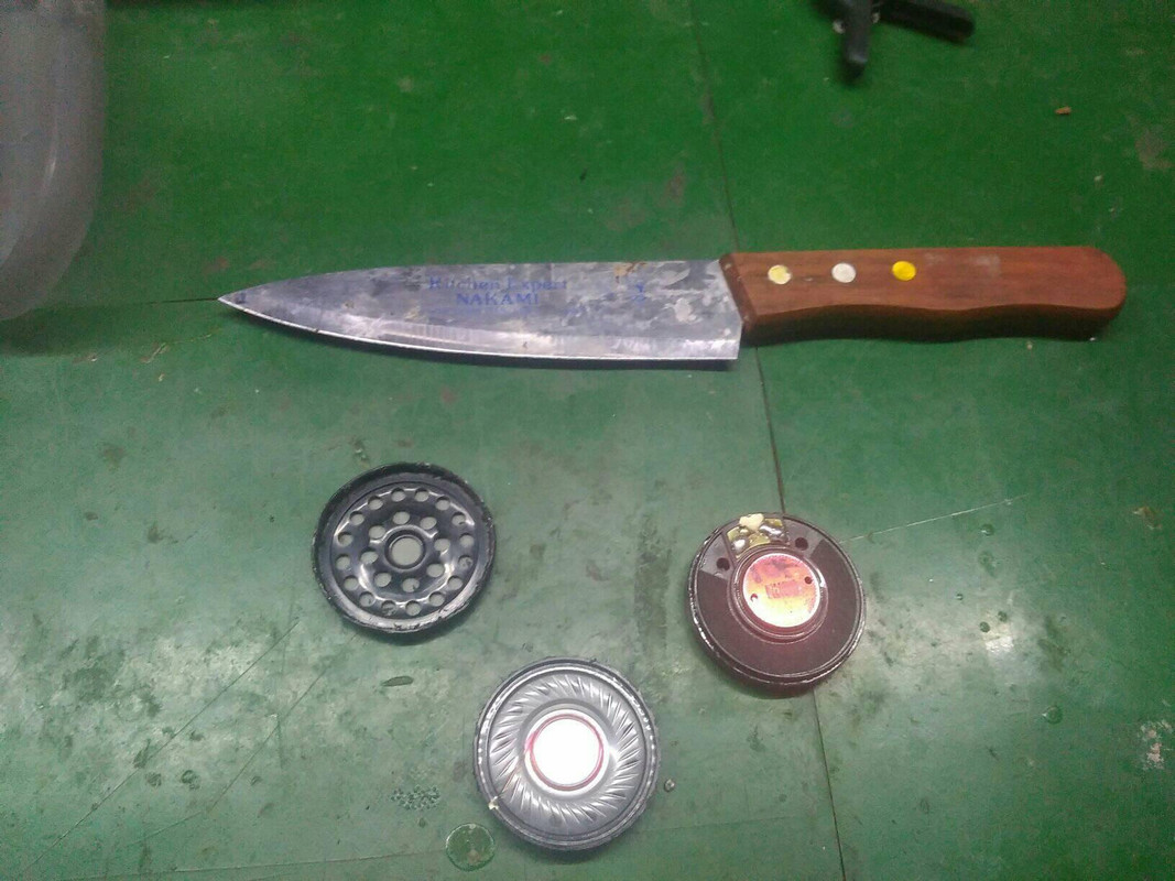

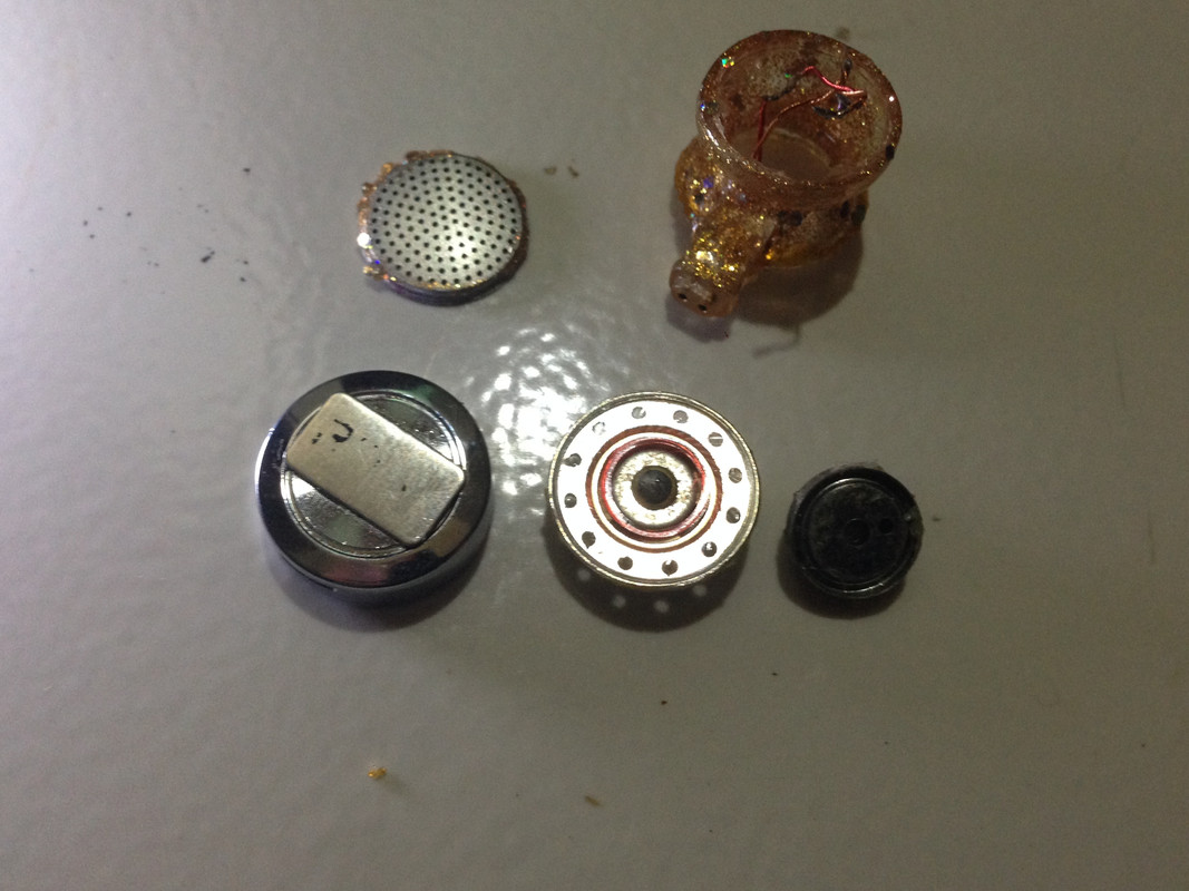

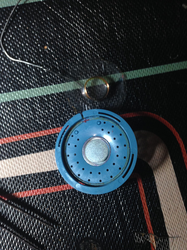

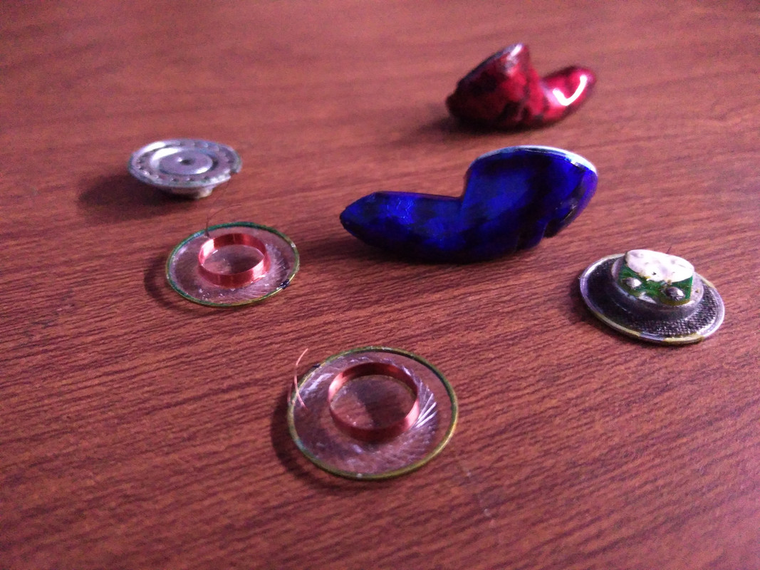

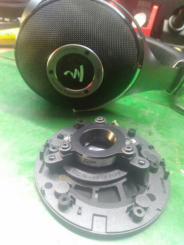

And here several cans of many that i have fixed.
