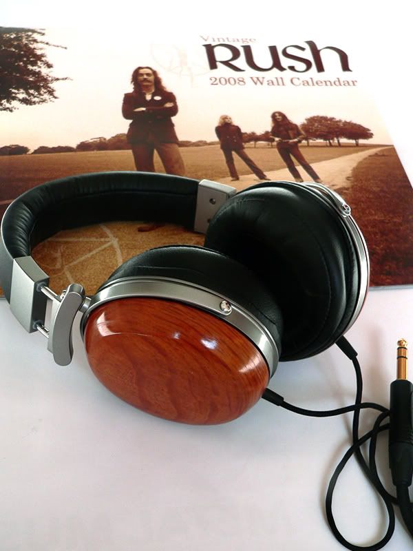

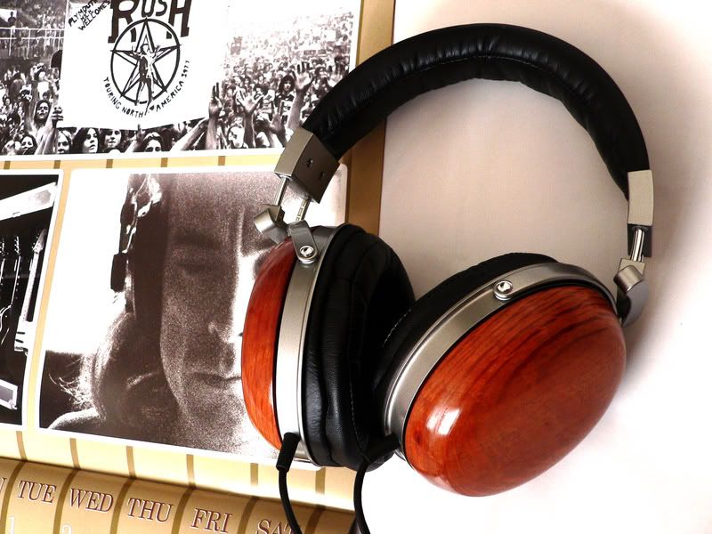

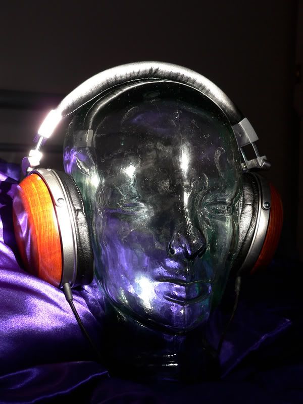

And finally, few pics of Denon D2500.
And how they sound? Most importantly, the mod didn't affect the Denon's sound signature. I didn't end up with a bass monster, anything like it.
I can certainly hear improvement in trebles, no graininess, nice and smooth, but sparkling. Midrange and bass is just as same as on D2000. I cannot detect any bass bloat or extra vibration (and and cranked it pretty loud at times) as reported by some D5000 owners.
So, all in all, I'm happy that I created something unique, cans are really good looking (IMO) and I'm happy with the sound. Cheers!
