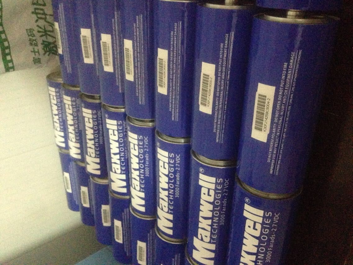

Hello Riemann,
I forgot, you use this Amanero?
You told me before it can accept 3.3V to 5V (which is 5.5V max), so this means you can use ultracaps seting
with voltage drop from 5.4V (max of 2x2.7V ultracaps) to 3.3V.
Sad thing is, as the picture shows, it consumes 250mA which is a lot power.
Runtime of ultracaps will be very short. Probably you will have to go for the bigger and more powerfull ultracaps,
at least the 350F Maxwell / Lishen, or the monster ultracaps 3000F from Maxwell, but those are expensive.
Please take a look at these, can you ask supplier which version he sells since there is 3000F / 1200F and 700F in his advertisement.
https://world.taobao.com/item/44672748313.htm?spm=a312a.7700714.0.0.FMLmy6#detail
These would be best to use for your application, you need 4 pieces.

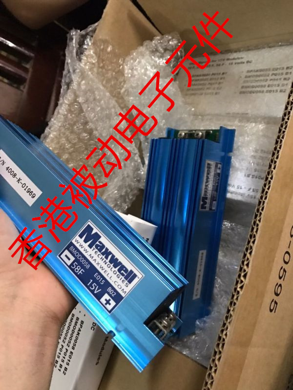

Hello Riemann,
I found some real interesting ultracap modules which can be used for powering Discrete output stage.
Would need several in parallel to achieve big buffer, but they are very good and cheap.
https://world.taobao.com/item/540618329466.htm?spm=a312a.7700714.0.0.AhFN6K#detail
