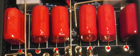

@bcowen couldn't the 12 points just be heated up or de-soldered and the cap leads be pulled out?
I think this would work: Dayton Audio PMPC-10 10uF 250V Precision Audio Capacitor, and keep the 10uf x 6
Possibly. I'd be concerned about getting a good solder connection with the new cap leads without being able to get to the solder pad(s) on the circuit board though. I also tend to be anal, so there's that. :smiley:
Cheaper than the Vishays, but I don't know anything about the Dayton caps. They could be quite good...I just don't know.
