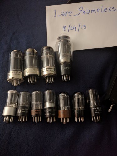

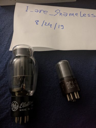

So I just bought a bundle of different tubes for the DV from a seller on r/avexchange. this is what's coming;
Raytheon JAN 6080
GE 6080
Tung Sol 7236
GE 6AS7G
RCA 6SN7 (x2)
KenRad JAN-CHR-6SN7GT
TungSol JAN-CTL-6SN7GTA
Sylvania 6SN7WGTA
Hytron JAN-CHY-6SN7GT
RCA 6SN7 (smoked/grey glass)
Got all of these for $100... Did I do good? Any decent ones out of this lot I should try first once I receive? I already have a TS 7236, but all the others are new territory for me.
