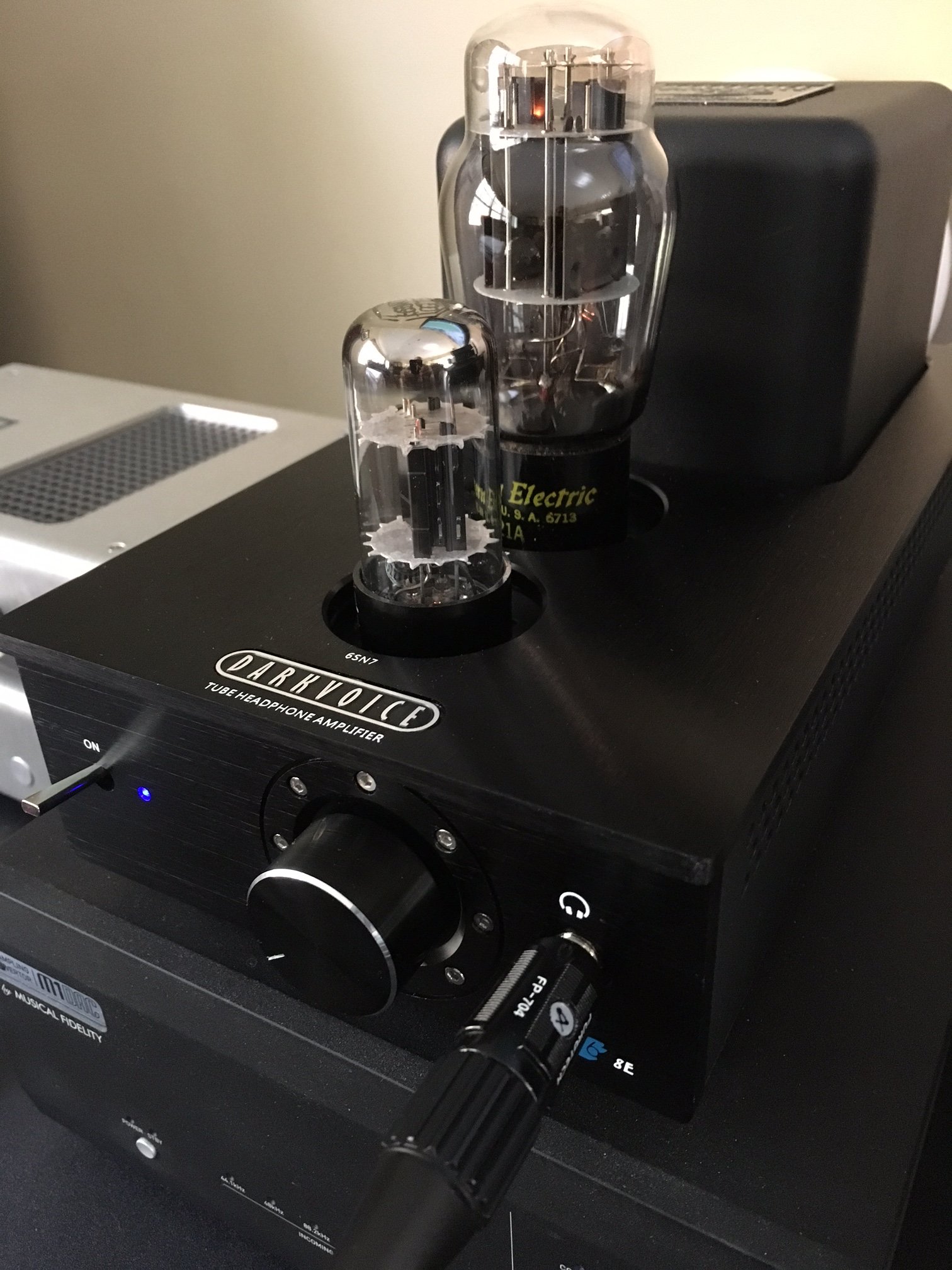

421A Power Tube
NOS USA Tung-Sol 7236 Power Tube

Driver is always USA NOS Tall Bottle 6SN7

421A slightly more power. Tighter deeper bass. But the 7236 is not that far behind. Then you have the 5998. finally the 6AS7.
