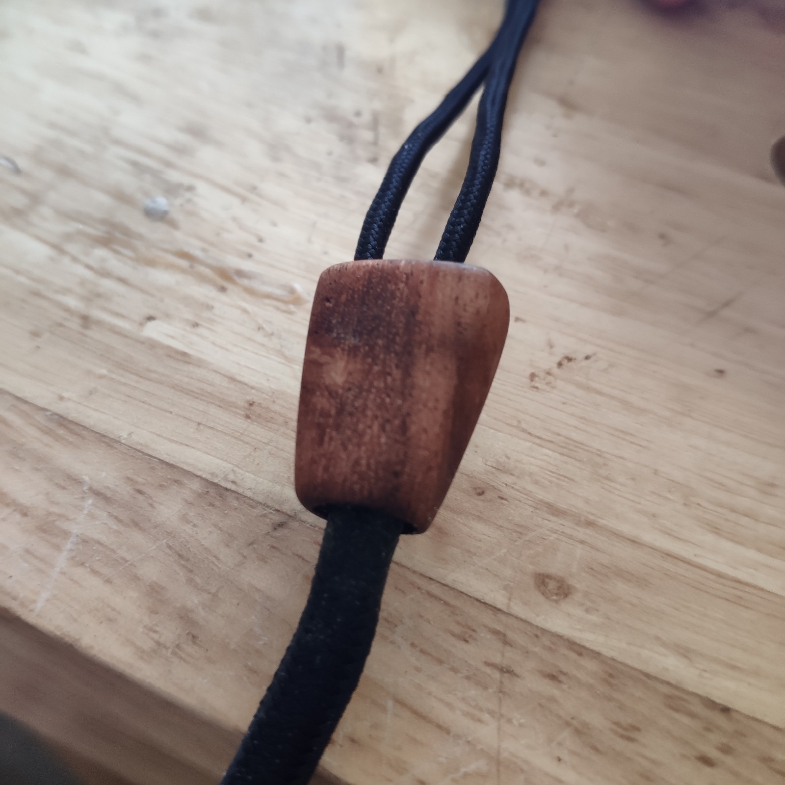

A long while back I switched the factory D2000 cable with a D5000 one I found here. While better, it still had a lot of the same issues the original cable had with it's length and kinking because of its stiffness. I added 3.5mm jacks which meant trimming the baffle a bit and widening the original holes in the frame. I shortened the cable about 3-4 feet and added the TS plugs. I made the Y-splitter from scrap pieces of walnut and oiled it with Danish Oil. Super happy with how this came out in the end and the detachable ends should prevent the kinks.

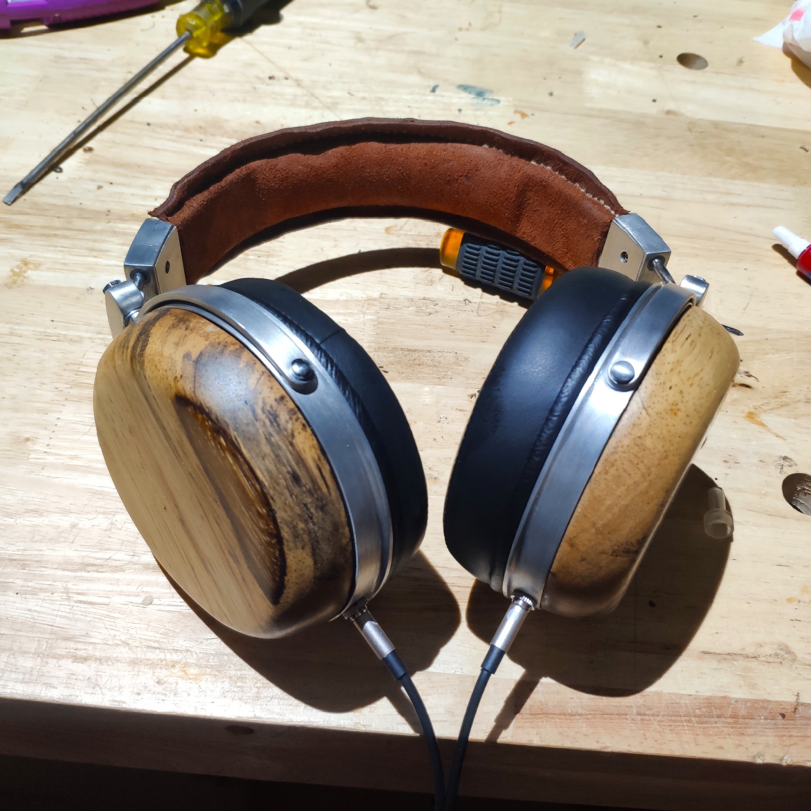

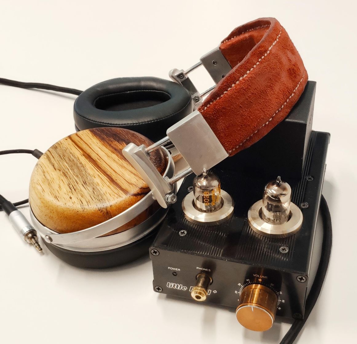

Here's the completed product which I'm very happy with. Unfortunately I hadn't listened to the headphones in years before fixing everything so I can't describe the differences in sound but overall they do sound better to me.

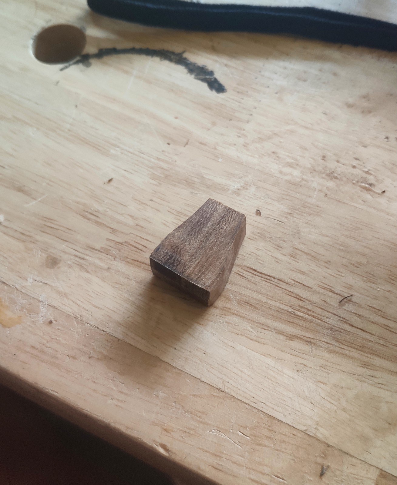

The Y-splitter made from walnut. I just drilled halfway through with a larger bit, and diagonally with smaller bits until the holes connected inside..
The final cable...
View of the headphones with the 3.5mm jacks (the cable attached is a cheap one i found on amazon before I redid the D5000 cable...
