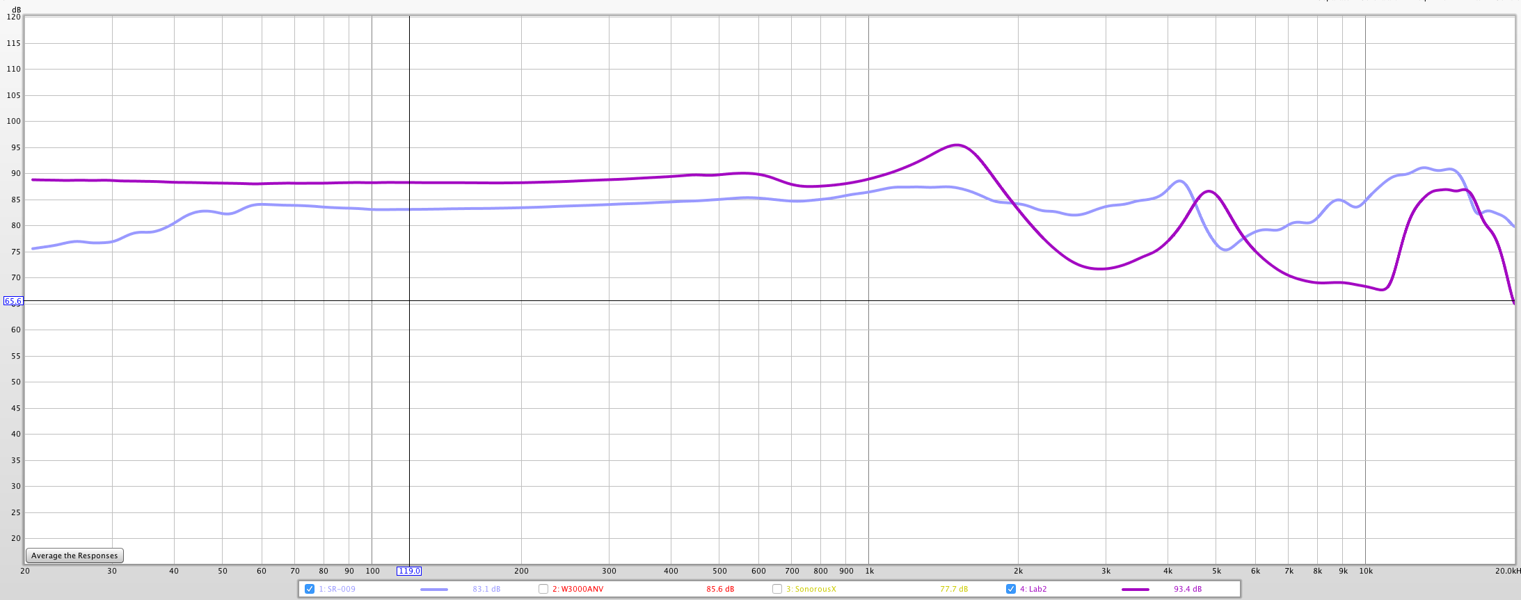

Next we have a comparison of Final Lab2 and... Stax SR-009. Important note: Lab2 were inserted as an in-ear IEM, I'm not sure if this is completely correct. The ears of EARS are too small to place Lab2 correctly in the concha. I will try to measure again in the future. But still, It's outstanding how flat Lab2 seems here up to 2kHz, even more than SR-009.

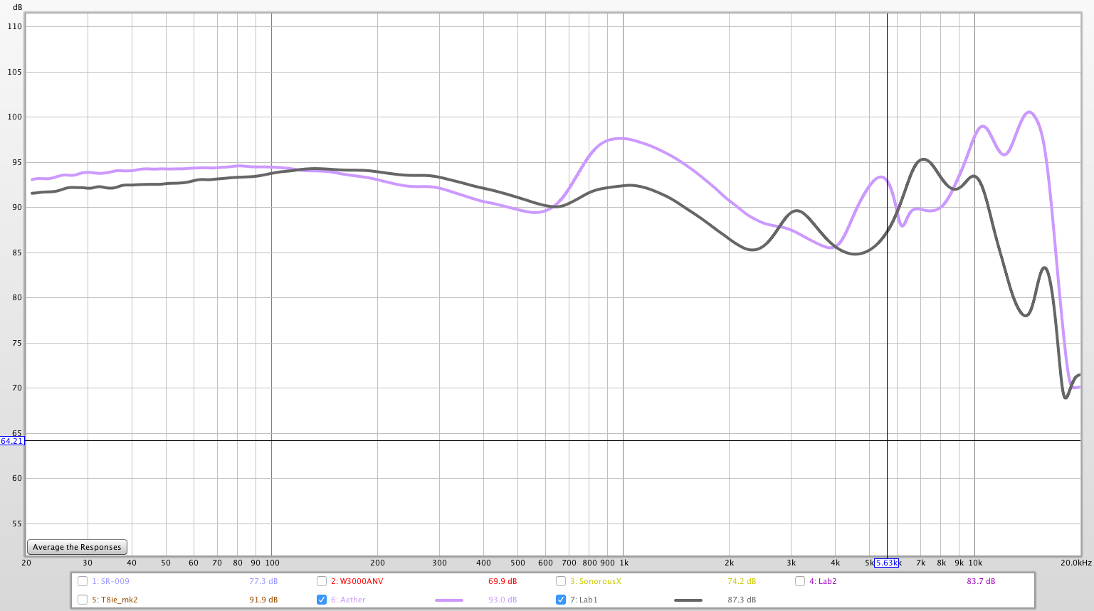

Last but not least we have force fitted Lime Ears Aether versus Final Lab1. Nice!

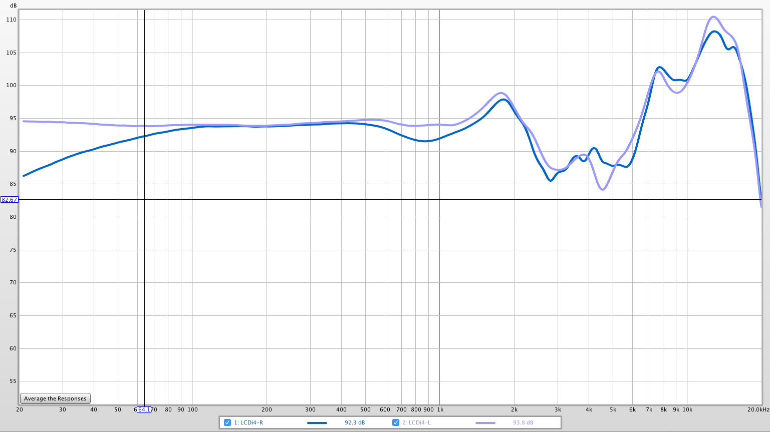

Bonus: channel differences in the sub bass and lots of highs on LCD-i4.

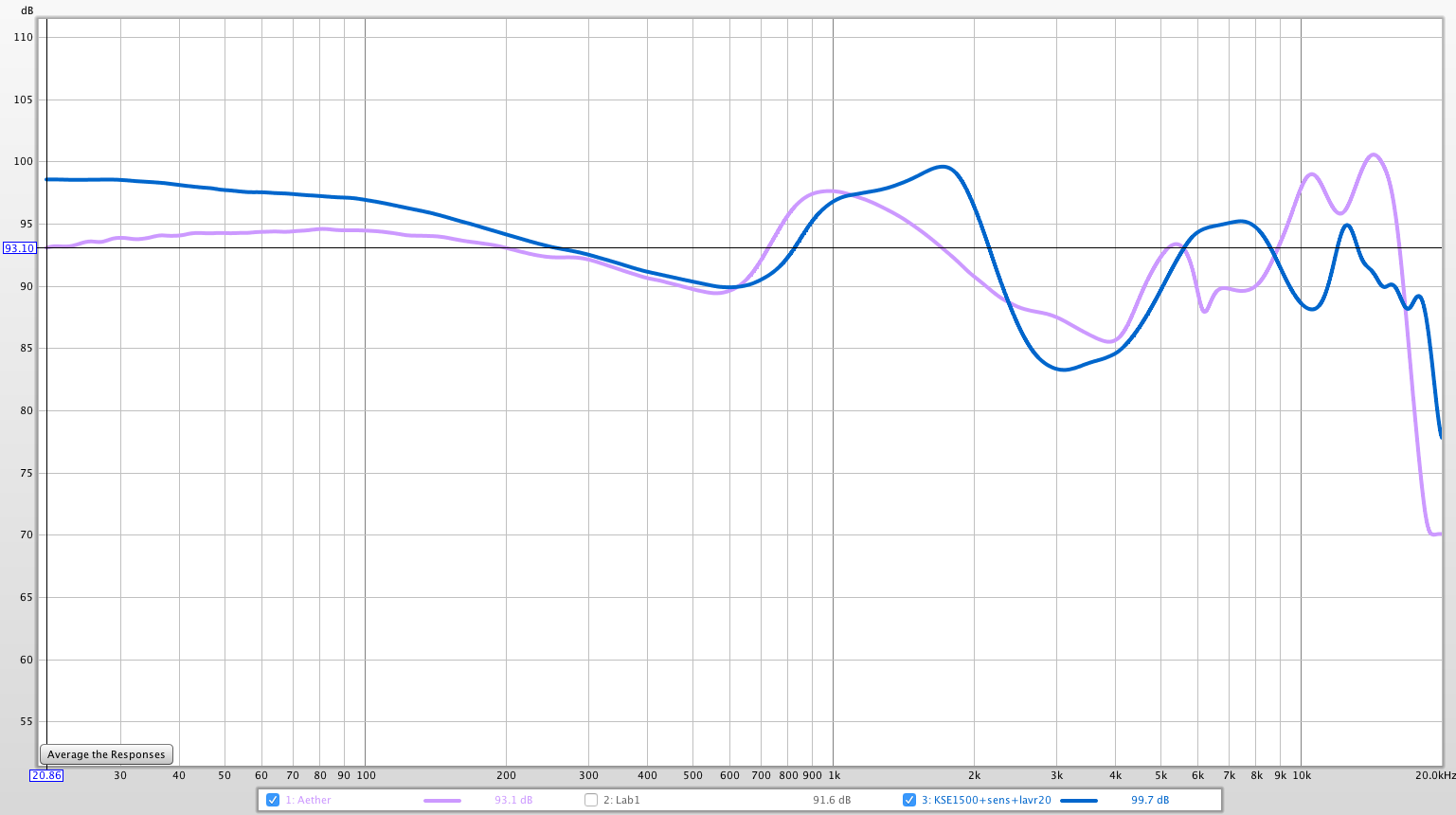

And a cherry on top of the cake, Bonus 3: LEA versus KSE1500 custom shell by Sensaphonics force fitted! This one sounds pretty flat and reference tuned to me, seems I'm deaf after all. Or there's some psychoacoustic shenanigans going on here. Even though they may look similar on the diagram here, KSE1500+Sensaphonics is a killer-of-all IEM.

At this point it's mostly a matter of art because I can't predict how you yourself will perform the mod. To start off, make one pinhole at the back vent tape. Next, play around with front vent tape by poking around. The goal here is to get as little bass as possible without rolling off; I'm essentially aiming for a linear, EX1000-style bass as much as possible. Once the bass is at the desired linearity, switch the nozzle dampening from two layers of teabag filter to three layers. The reduced lower-frequency response seems to make the sound a little more shrill, so just a tad extra attenuation in the upper end is recommended in my opinion.
The final FR should be like so:
Comparison with "simple" mod
Comparison with stock
Some additional choice comparisons with other IEMs:
Against InEar ProPhile-8
Against Etymotic ER4SR
