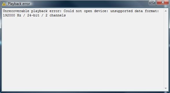

I have a question regarding 192khz as well. I have a nice Daft Punk vinyl rip that is in 192khz. I get this message in Foobar (bit-perfect/WASAPI):
Clearly my DAC can't handle the 192khz so I am looking for the best way to change the rips to 96khz. Can anyone help me out?
I was under the impression that the DacMagic does support 192 (but maybe not if you're using the USB interface?).
I'm on a Mac, so I'm not familiar with Foobar, but what you want to Google for is something like "downsample foobar" or "downsample flac".
http://i12.photobucket.com/albums/a2...g?t=1243761209
Looks like a file playback issue to me.
Are you sure Foobar2000 can handle the bit-depth and sample-rate, with that codec/format (whatever it is)?
