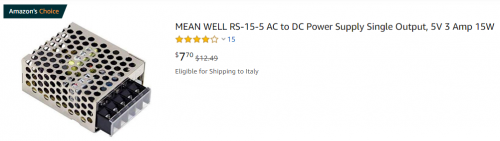

What does a linear PS get you that the battery won't, other than alleviating the need to recharge the battery every once in a while?
I am also thought this way, but it's not that simple.
Power bank inside will have circuit to stabilize 5V from LI-Ion..
And in many cases it's crap.. a lot of noise and non linearity. At the end it was deigned to recharge our gadgets and not for hi-fi audio components.
So, not that easy... still good switching supply or LPS is the way to go here.
I heard many good words about this.. and it costs nothing.
https://www.amazon.com/s?k=MeanWell,+RS-15-5&ref=nb_sb_noss_2
