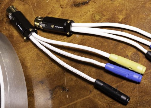

Any cable recommendations for connecting DAVE direct to speaker? I am looking at some Omega speakers to try w/ DAVE.
I think there is an argument for using traditional off the shelf speaker cables with banana plus on both ends and using a short XLR to banana converter set at the Dave (and TT2) end. Especially if you are just trailing speakers that you might not keep. That way also you will have speaker cables that will appeal to the wider market if you decide to sell them at a later date.
Rob Watts gave a detailed summary of how he made his converter tails. I did it slightly differently in that I used 6mm2 cables rather than multiple smaller diameter cables to get the cross sectional area. Also, I used Furutech XLR plugs because they can take larger diameter cable compared to Neutrik XLR. There are however various companies which people have mentioned as selling off the peg versions.
Also, because I was also trialing running speakers direct from Dave and TT2 I wasn't sure whether I wanted to run them in single ended or balanced mode hence why I connected all three pins to the XLR plugs.
EDIT - it has been pointed out that the RCA output from Dave is lower impedance and so is preferable to the XLR. I have made similar short RCA to banana conversion leads for Dave and forgot to mention that.
Hope this helps. (click on the thumbnail image to view it at a larger size)
ATTACH]2628194[/ATTACH]
I think direct drive from DAVE at least (...not sure about TT2) is best via the single ended RCA outputs as that is the one with the low output impedance.
Rather than having several junction points, I got Dave at Zenwave to make me RCA to spade connector speaker cable which works very well.
G
Thanks for that. I have gone back and edited my post to clarify. Nick
Yeah, the XLR out from DAVE has extremely low Current output and won’t drive really anything. It is only meant to feed Voltage to an external amp.
On the other hand the TT2 has 6A rms Current output from the XLR so, yeah, not really an issue from TT2.
