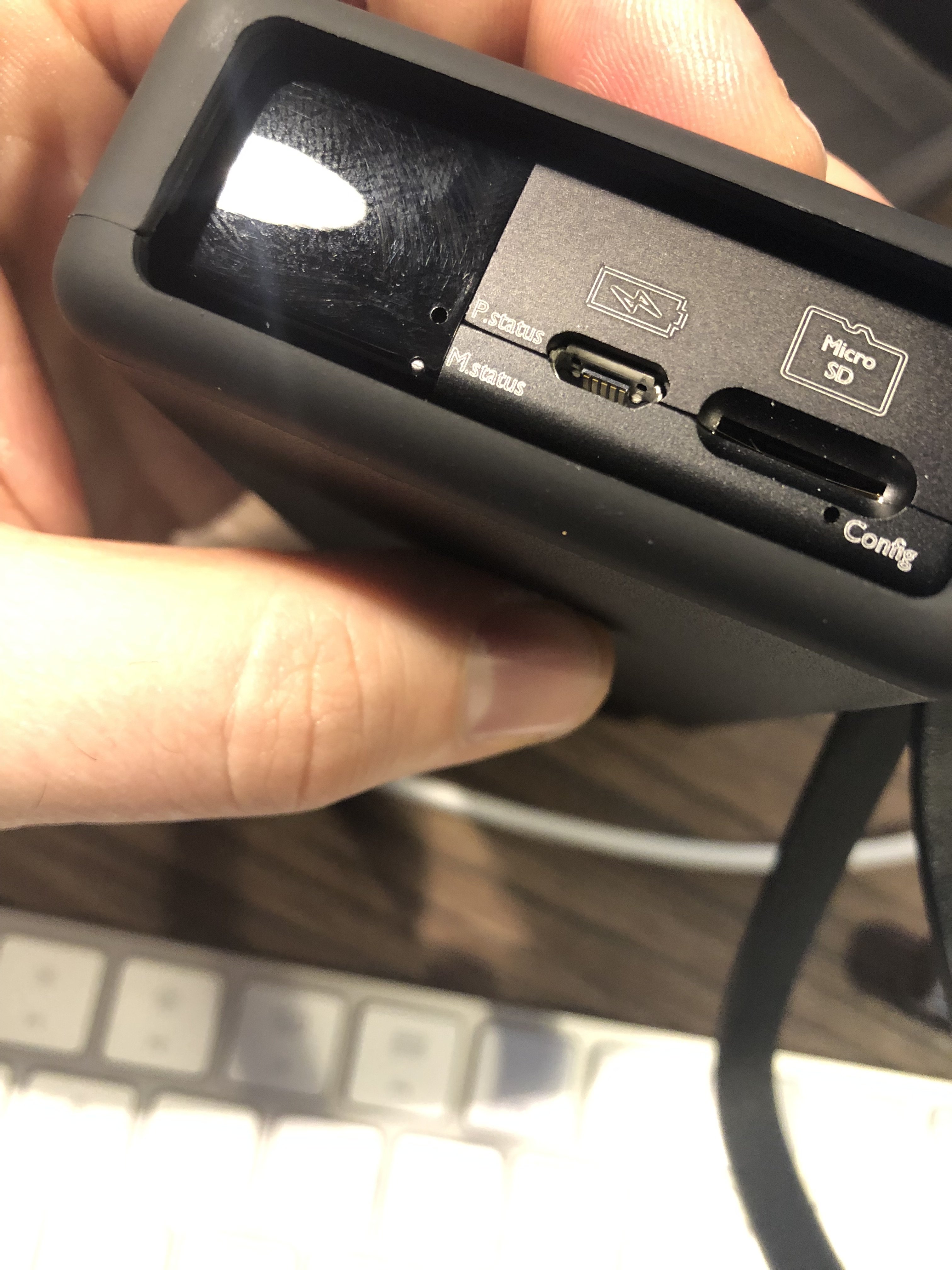

So I am owner of a Poly from today.
I took it out of its box and found that the P.status LED is missing the transparent cover - probably someone forgot to add it on the factory.
Has any of you seen this? I am thinking to return the Poly, as to me it looks a manufacturing issue.

@mandrei83 Thats just the way it is. The led for the p-status is recessed a bit, and the m-status is just a fiber optic thingy that runs back to the light of the mojo. Dont think thats a defect or an issue, just the way its designed. Mine is exactly the same.

Hi @mandrei83 There is no issue. The P Status is a hole with an LED behind it. The M Status is a fibre optic light guide to take the light from the LED on Mojo through Poly so you can still see it. So you can see the hole for the P Status LED and the small plastic end of the fibre optic cable for the M (Mojo) Status.
Thank you for quickly clarifying this, I thought that it was something which my Poly has came up with from the factory.
