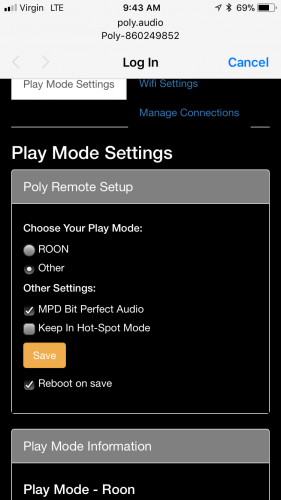

    Here are my latest steps following the above guidance:
    "You need to be connected to Wi-Fi (either your home network or iPhone hotspot) in “other” network mode."
    I am connected to my 2.4GHz Wi-Fi network. I'm unclear about the "'other' network mode" but here are my screenshots​
    "From the Poly’s hotspot mode, you can set up your home or phone network, then select “other” mode and check reboot on save."
    I selected "Other" and "Reboot on save" as seen in the screenshot. I'm a bit unlcear about "hot spot mode" as my iPhone doesn't have hot spot capability, but I think that is something else.
    "That should restart you in other network mode. Then follow the off, on, off procedure to update the firmware."
    After executing, the P status light goes out for ~30 seconds, and then comes back on flashing blue, not a solid blue. My iPhone reconnects to my Wi-Fi without displaying the Poly as if the Poly exited access mode.
    As I understand it, there is no point in cycling the power off and on as I don't have the solid blue indicator which is kind of key at this point.

  5. smaragd
    From the Poly screen shot I notice that your Poly is in Roon mode... I suggest you DO reboot into “other” mode first and retry connecting... there is a point in rebooting in your case I guess...

  7. Signal2Noise
    FYI, that screenshot does not indicate the Poly is in Roon mode. The selection is set to "Other". If you are referring to the bottom part of the screen where it says "Poly Mode - Roon" that is just the start of the explanations for all the different modes Poly can be placed in.
