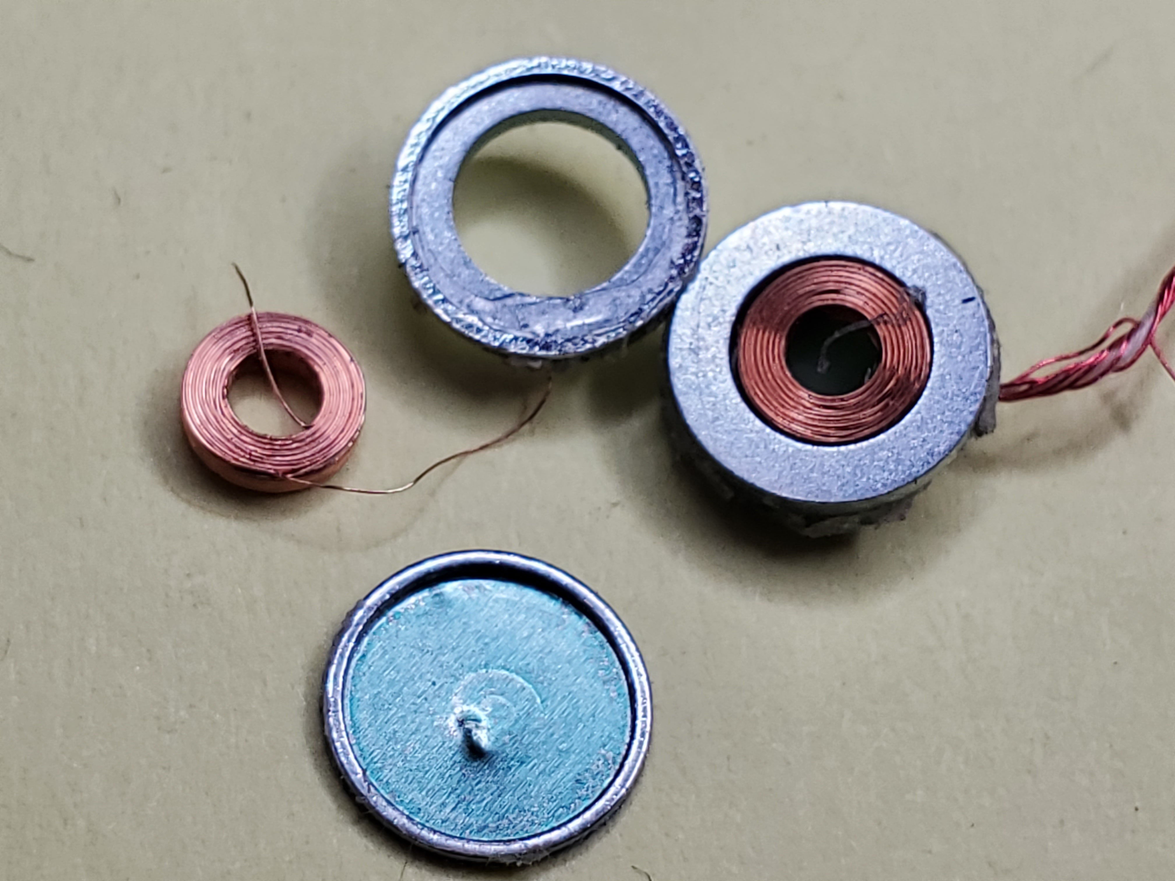

Added a switch for the electret driver for fun and easier comparison.
Seriously, it sounds so so much better without the electret.

Rather difficult this time probably due to tighter fit and stronger glue but the procedure was the same.Nice work and was the front cover easy to remove?

Indeed, the smaller unit is much less prominent in response.Added a switch for the electret driver for fun and easier comparison.
It is definitely not an electret - either some magnetostat or some flat suspended membrane.
Here are the inner parts:
Two symmetric coils inside the ring magnets (8 Ohm each connected in parallel, so the total impedance is 4 Ohm).
In between is the rigid metal membrane that is at the bottom of the image. Interestingly, it is magnetic but not magnetized.
I am not sure whether this design is similar to other MSTs or some unique construction of KZ/CCA.
Because of the very rigid membrane, the amount of sound it can produce is fairly limited, and the range is limited as well: some output is from 1.2 kHz to 12.5 kHz, while the sound can be heard reasonably in the range of ca. 3.5 kHz to 7 kHz then decaying to oblivion by 12.5 kHz.
P. S. It was really hard to disassemble, please do kids-friendly designs next time, KZ/CCA
