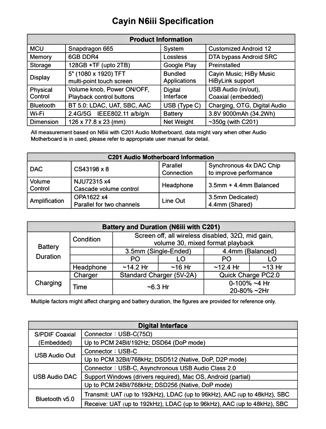

Looking at it all more calmly, now that the excitement is behind me, it's a DAP that I like more and more, 700mW is perfect for me, the battery life is great and the THD, SND, Dynamic Range, SNR and channel separation specs are very good and high level, but what I like most is that it maintains a very low output impedance, we often overlook that fact but having an output impedance of 1 ohm is really important to properly drive many IEMs that are sometimes even below 10 ohm, hopefully someone can compare it with N7 in the next Canjam! :)

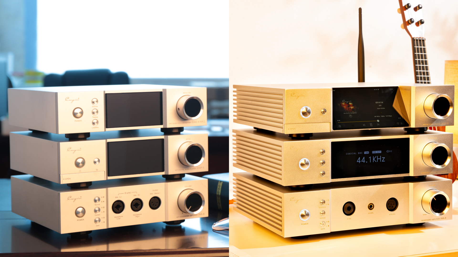

In February 2024, Cayin launched the “888” 8-series 3-piece suit (Streamer, DAC, HeadAmp), a major upgrade of the desktop “666” 6-series 3-piece suit; March saw the release of the N3Ultra Vacuum Tube DAP, the third generation of our entry-level DAP (illustration); and in September, the C9ii portable headphone amplifier replaced the groundbreaking C9 since early 2021. Within weeks, the C9ii earned widespread recognition from users, partners, and the media, just as its predecessor did, becoming another standout product
6-series 3-piece suit (2016~2019) vs 8-series 3-piece suit (2024)
