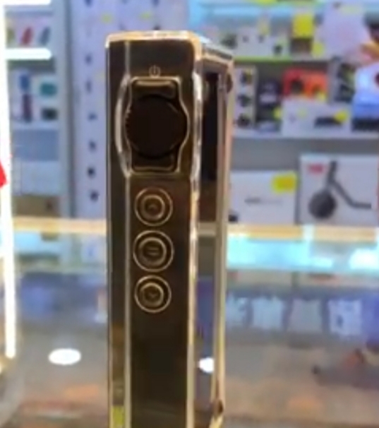

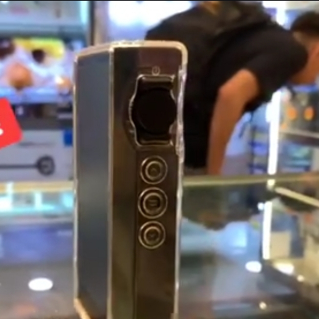

New case for the N6II.

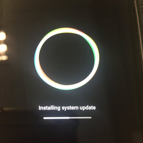

Happy to report successfully updated via OTA :)

Yeap, OTA is the way to go with N6ii firmware update. We are using progressive update when you go for OTA option, so only a small portion of firmware code will be replaced - in order to shorten the download time. If you were to perform manual update, you have to download the complete firmware package and that is around 800MB. If you still prefer to do this, please use Google Drive download option (HERE) because you get faster short term bandwidth during download.
