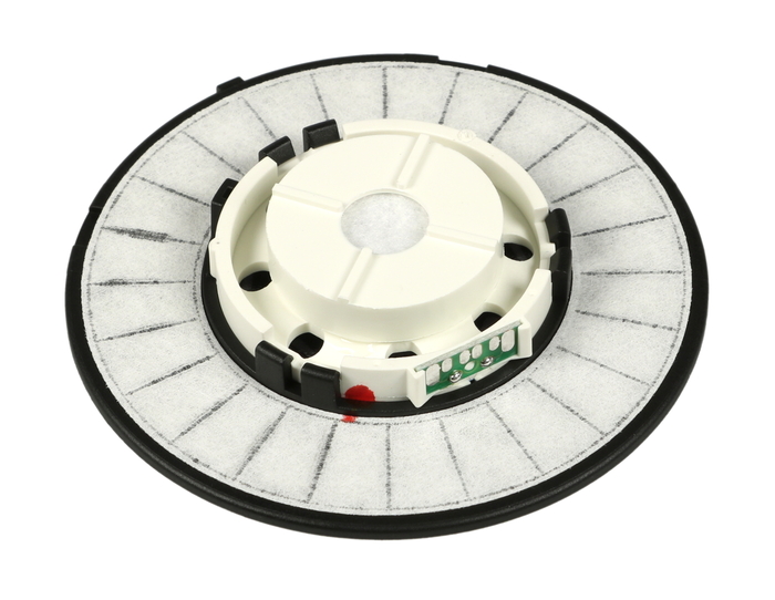

I accidentally break one of my drivers on my dt880.
I decide to by new pair, and even triple the price and order the t1 driver.
do you think that it can work?
in addition I done some mods on this headphones and add detachable cable option and want to buy newer pads.
What do you think?

The T1, T5p and other Tesla drivers are made differently than the 770/880/990 and require a tight seal on the driver chamber. I haven't done the measurements but I don't think it would be a drop in replacement. That being said... I'm sure you could rig something up if you were so inclined. Just an FYI, Beyer USA sells driver replacements directly and they're very easy to deal with. I've repaired quite a few over the years. The cost is around $60 for an individual driver IIRC. Best of luck to you!

I see the same plastic inside in each of this drivers and the same venting hole

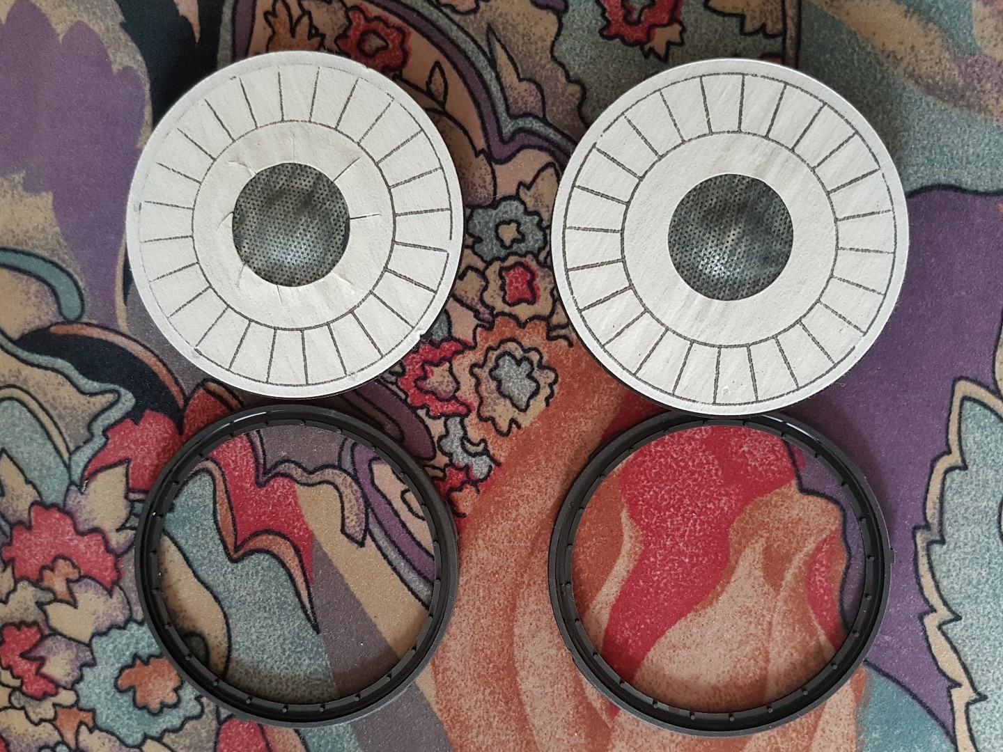

how can I replace to white foam inside the caps of the headphones?

Looks very nice, good work!
Now I need 90mm pads, that use DT880 material.
Where can I buy the inside foam/wool from DT880 ?
maybe return the driver to DT770?
