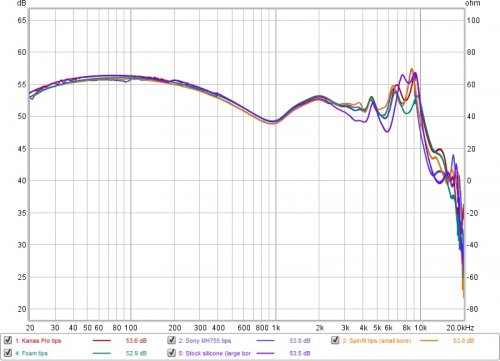

I got a new iem measurement rig and conducted some measurements of Andro with various tips. This should convince tip rolling is real.
This is the tip that I considered sounds most right. It's the stock Kanas Pro tips with pretty good bore size

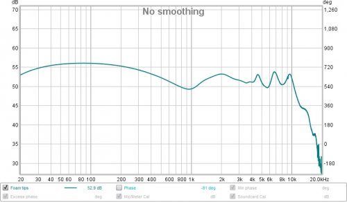

The more interesting part is how the response changes with various tip types such as bore size and material (foam for example).
Stock foam. You see how the foam dampens the treble peaks?

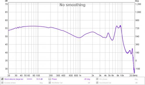

Stock silicone with large bore (comparatively to Kanas pro tips above and Symbio W). You see how the large bore size raises the treble area?
There is no placebo regarding tips rolling. It is too obvious.
The problem i got right now is the only tips that sounds good to me is spiral dot as i love soundstage and separation.
What other tips that can give the same feeling? Really eager to try other tips that has wide sounstage and separtion.
What about symbio w? It is on mail. Looking forward to it.

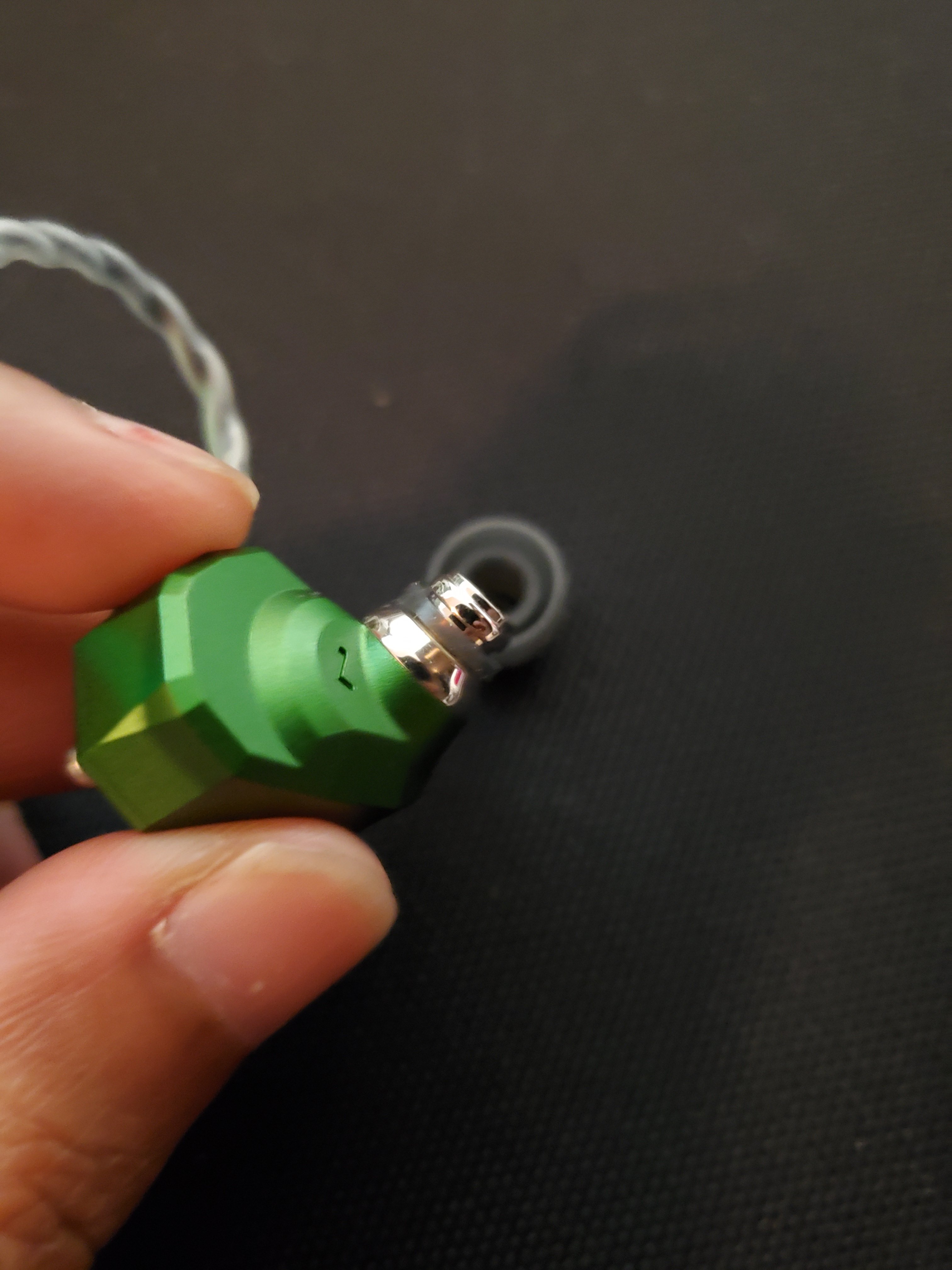

Is there anyone here try to raise the tips by putting some small ring on the nozzle before putting the tips? I just tried and it improves the seal A LOT and the bass is improved without sacrificing mids and sound separation. Give it a try. Just cut tips that u dont want. It needs to be really small since the andro nozzle is so shallow already.
Can you post some pictures on how you did it?

OMG man, I tried with an old tip that I had on a desk and I can certify that the isolation improved like 200%, the bass was improved too but definitely the quality remains the same in terms of mid/highs. For everyone who can try, give it an opportunity :)
