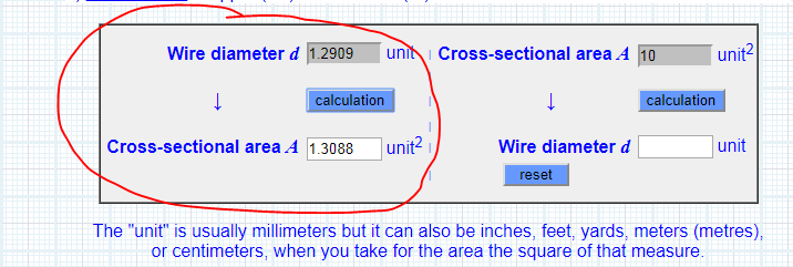

Just for fun. This site is full of audio calculation tools:
http://www.sengpielaudio.com/Calculations03.htm
There are tons of methods to calculate wire properties.
Here is one way that you can play around with the different properties and values to see just how small the changes are in most typical consumer applications.
Assume we want to look at a 4 meter long, copper, stranded, 16 AWG speaker cable.
An online calculator is available that automatically converts AWG of solid wire to the diameter in mm. This conversion tool is located near the bottom of the page under the following heading:
Conversion and calculation of cable diameter to AWG
and AWG to cable diameter in mm - American Wire Gauge
http://www.sengpielaudio.com/calculator-cross-section.htm
For a stranded wire, we need to convert the wire diameter to cross-sectional area. The same link from above also includes the tool for converting a solid wire diameter to cross-sectional area:
Again, this information can be calculated on many similar sites.

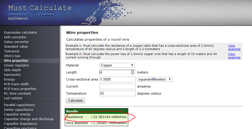

Here is one example that is very basic and easy for someone like myself to use:
http://mustcalculate.com/electronics/wireproperties.php?mat=cu&l=4&area=1.3088&areae=mm2&temp=25
You can easily change the parameters and see how much of an impact it might create. I only see a few milliohms difference between silver and copper until you start using very long or thick wires. The tiny amount of attenuation from using copper over silver would be minimal and most likely insignificant compared to the room acoustics. It's possible that placing a beer a few inches in one direction or another on a table might impact the sound more than changing from copper to silver wire material. I'd like to state for the record that I would love to volunteer myself for that experiment, provided the beer is fresh. :beerchug:
