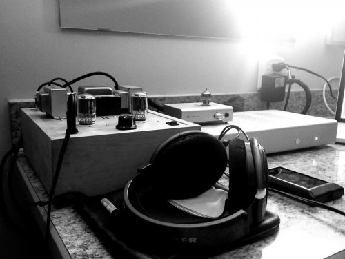

Hi Gang, I'm looking at purchasing this pre assembled S.E.X.
Can any of you wizards tell me from the images which model this is?
Apparently it was purchased on Head-fi around 2-3 years ago.
My best guess is 1.0, with C4S.
Let me know your thoughts!
Looks like my SEX 2.0. With the old iron. ( Chokes and Output Transformers ). You can upgrade the Iron, but the c4s upgrade isn't sold anymore. So having c4s is a plus.

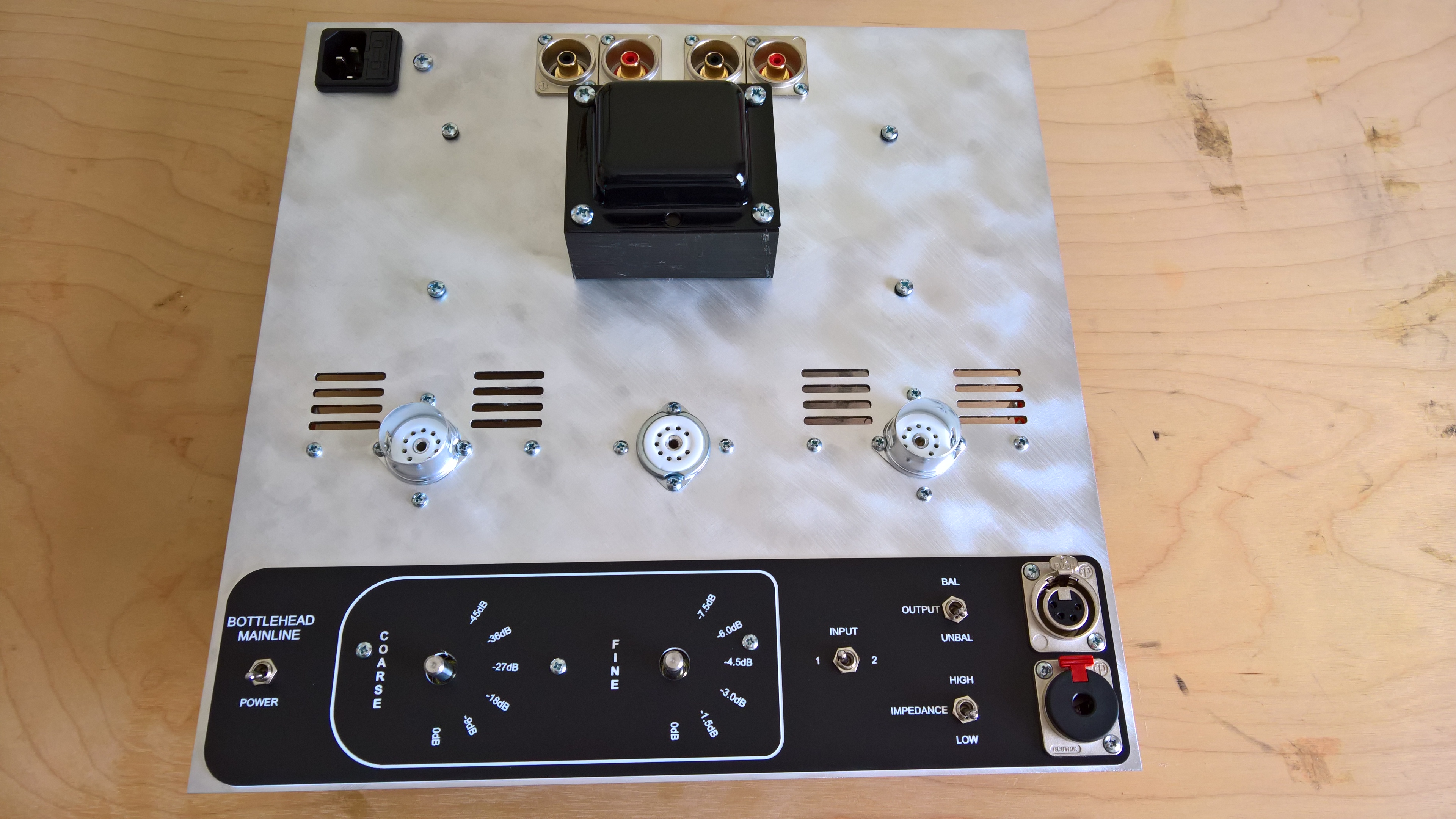

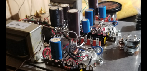

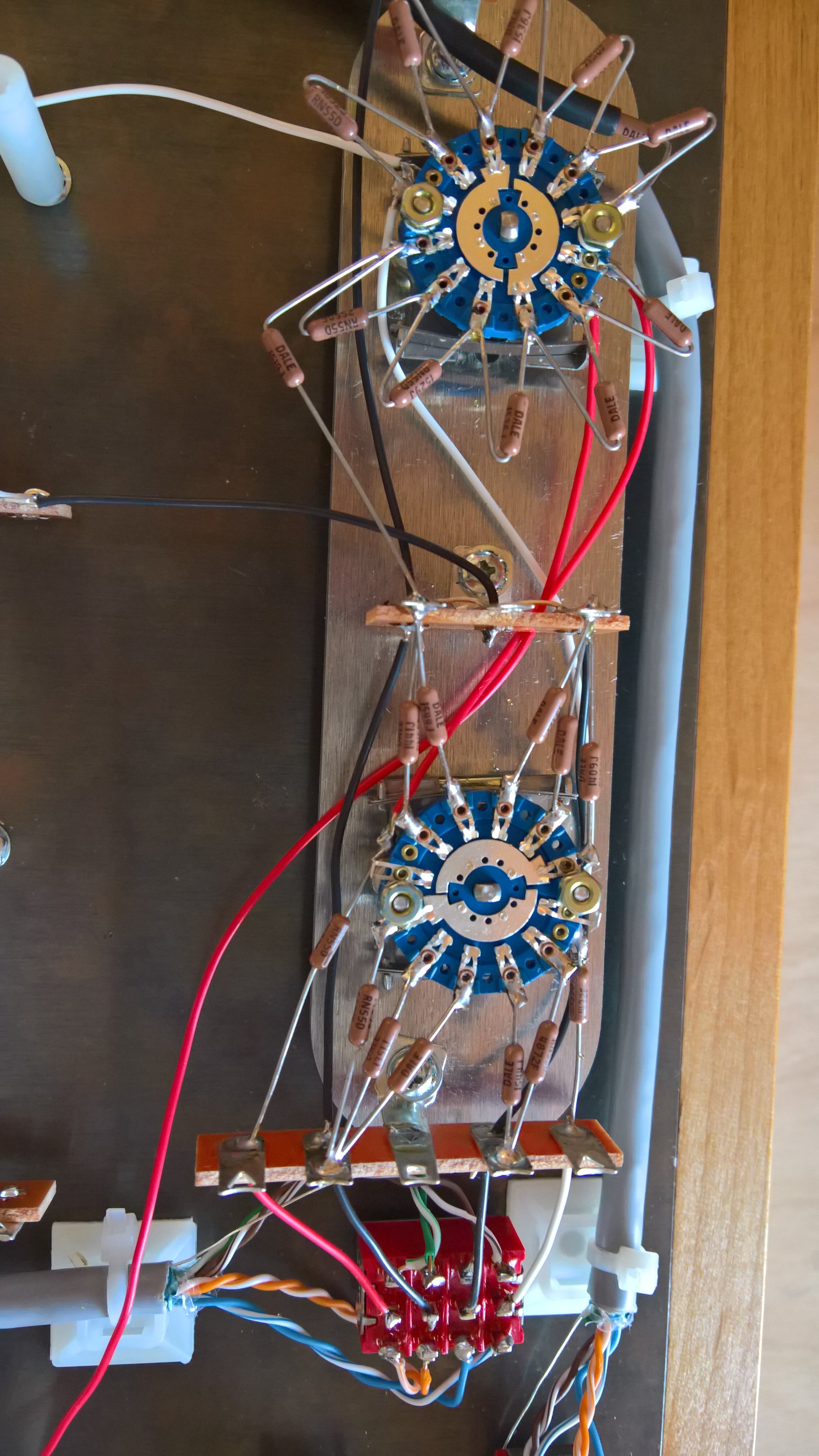

Well, we started the Mainline build today...got the kit yesterday and took inventory, was missing two 49.9 ohn resistors and one #6 fiber shoulder washer for the smaller transformers. Waiting on BH to ship me these.
But lots to do in the meantime, populated the 4 circuit boards andgot most of the stuff mechanically mounted on the main mounting plate.
Glued the base, sanded down and got a first coat of Tung Oil on it.
Painted the Power Transformer Bell Housing a nice gloss black and its drying overning and will install tomorrow.
Will recheck the 4 boards tomorrow for correctness...and start wiring up stuff....
Probably will not get this to totally power up until late next week I think...stay tuned

First power on test of the power supply passed!!...6.3VAC and 390 VDC....working on the wiring now!
