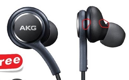

Depends if the blocked vent is behind or on the front of the driver. If it's behind the driver, it's used to get in air for the driver to move so blocking that would result in less bass. If it's on the front, it's used for air circulation and to vent excess air out, blocking that would result in all air being moved out of the nozzle into the ear canal, ergo more bass.
My old one built up some debree/gunk that got lodge inbetween where the housing attachment and the driver housing part is. There a cylindrical pit there, and there is a vent hole within that pit.
That's the left circle on the image, and the front vent is where the right circle is. My understanding is that if you close the back vent, the bass will reduce.

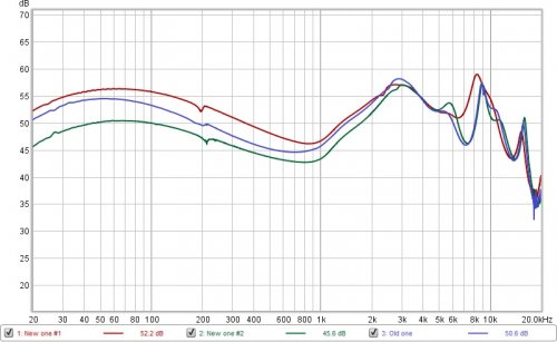

This might be a measurable burn-in proof if that's the case. I bought two sets a while back, the one I've listen too for the past few months has more bass than the other one I just unpacked now. I don't know if the diffrence existed from the beginning cause I haven't tested them. You have the ocasion to burn in a pair and see if it changes.
It might be simply a difference betwen batches too. There's a video on Youtube comparing the ones that come with S10 whith S8. Says S10 has more bass.
It's not burn-in, it's QC variance.
I've measured 2 new ones and the old one again, and overplayed them. Same output volume.
That would make sense, yeah.
