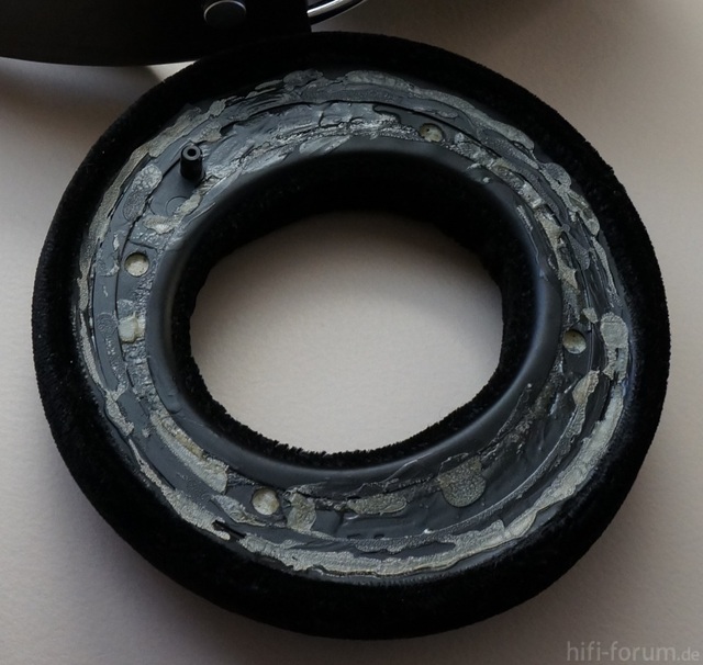

I just tore the earpads off. The plastic discs are glued onto the earpads, but when you remove the earpads they most likely come apart. The four pins do hold the earpads somewhat, but not very securely - there's additional glue on the pins. You can just "clip" the pads back on, but I'd recommend to put some glue there just to be sure.
As can be seen in this picture there's some glue residue on the pins.
