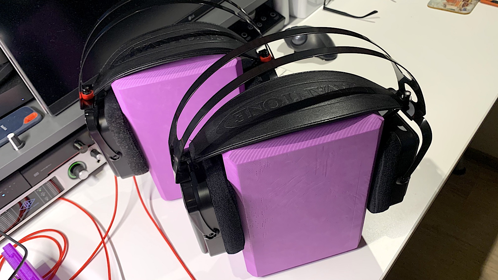

Got second pair of my friend's Planars, so I can compare both.
Out of the box, the second sounded really weird compared to the planars I own and listened to for about 100 hours. I tightened the screws, then compared again.
On the new ones, the sound became balanced and became similar to my heated planars, but the sound became brighter! They have more treble extension, have more detailed highs, while mine sound a bit muffled on high frequencies. Wow... I definitely prefer their sound, and I am a little upset because it will be my friend's headphones, not mine. ))
So I can definitely conclude that different pairs of the same headphones have different sound. Slightly but different! And you need to tighten the screws and check cables, otherwise you will have a weird frequency response and a narrow soundstage like one youtube reviewer.

That is very interesting. It makes me want to raid Avantones stock of headphones and find the one that sounds the best haha
What did you mean by "heated" or is that a typo?

Take a screwdriver, they must be tightened before listening.
my English is not as perfect as my hearing ) probably the word "warmed" or "burn in" would be better.
