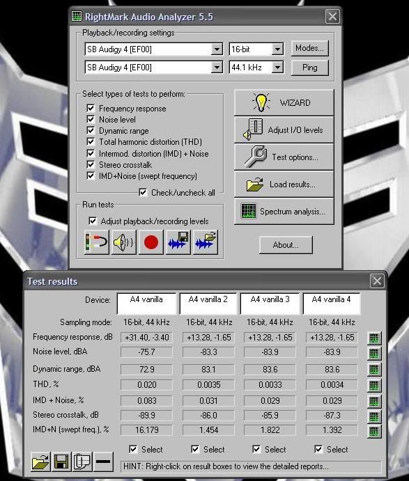

Aug 18, 2005 at 1:07 PM Post #7 of 19
Yup, these are definitely off (and measurements should be conducted primarily in 48 and 96 kHz, 44 kHz is more or less a resampling quality test only).
The card looks similar to an Audigy 2, that's true. It does, however, feature many more capacitors in the output stage around the opamps. It would be interesting to know how good it sounds subjectively.

Aug 20, 2005 at 3:54 AM Post #12 of 19
Originally Posted by jiiteepee
You maybe have EAX/CMSS 3D effects ON and/or you're using Monitoring with recording.
Thanks, I know the EAX/CMSS 3D stuff was off, but monitoring with recording not so sure. I'll read over those files. Thanks. In the meantime, here's some new results for a different sound card I found at best buy today.
X-Fi xtreme music
Anybody wanna let me know why the dyn range is all screwy on the x-fi card?
Aha...I see. Thanks, I'll keep that info in mind for future. As far as the A4 nonpro/vanilla/whateveryouwannacallit, I still preferred my revo 5.1.
