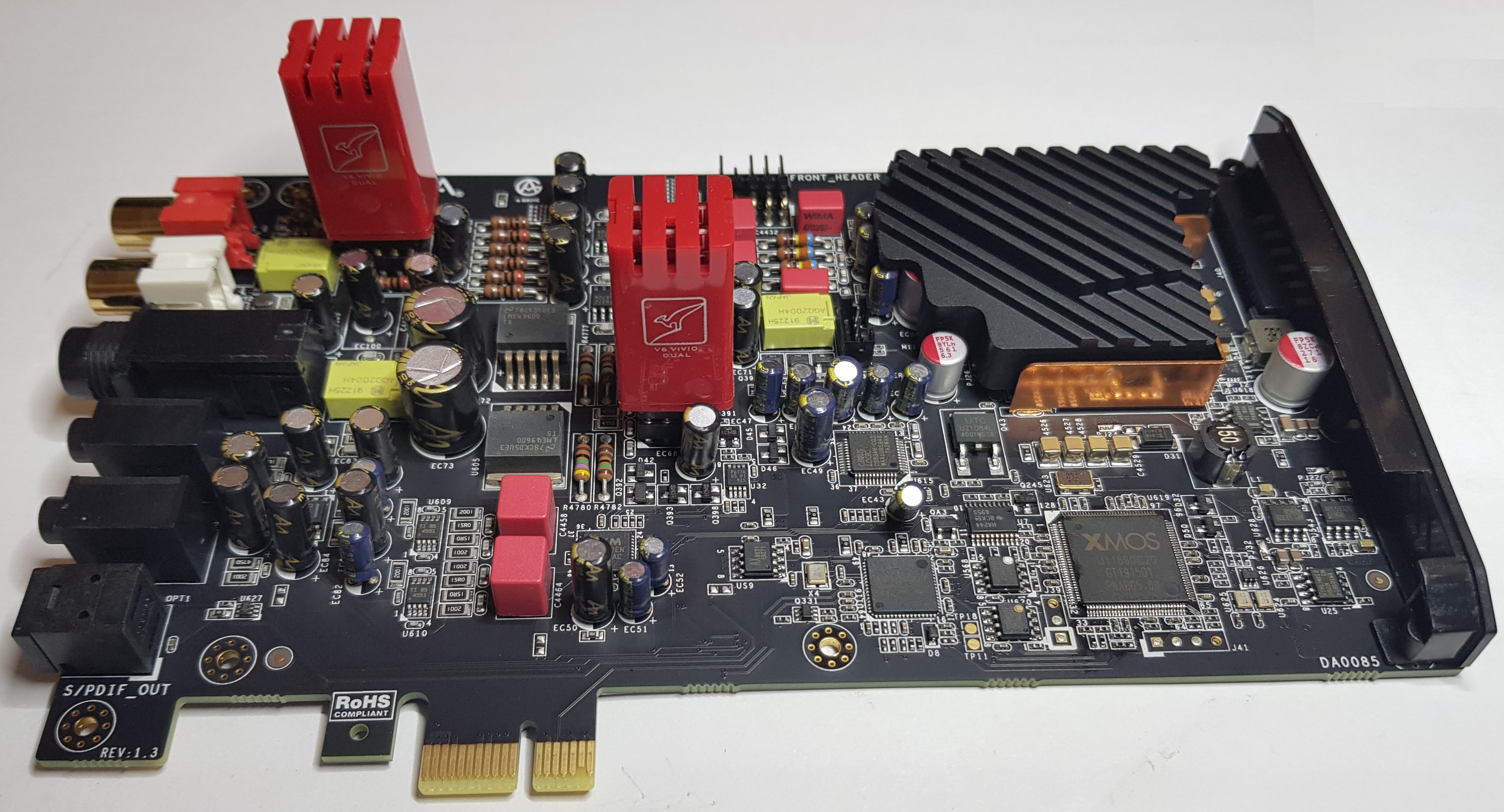

EVGA Nu Audio PCIe Sound Card
The EVGA, only has 2 OP Amps, the OP275 and the specialist AD8056 (The later should be replaced with care, check compatibility before proceeding with other OP Amps)
As with the ASUS Card above fitment is tight, the capacitor just behind the left most Burson, requires the same treatment of pushing it over to enable the Burson to seat properly. But as above this does not seem to have any ill effects. (Don’t push it to hard you don’t want to snap it off the board.)
Also the same problem exist with the EMC shielding not fitting back on without some modification. You will also lose the RGB lighting, when the cover is removed.
