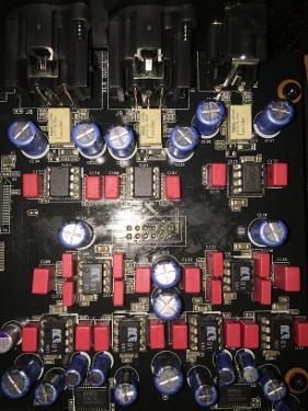

Now my E1 is full of LM4562/LME49720. It sounds glorious, so detailed and extremely three dimensional. Feels like a different DAC now. I can recommend this as a cheap, easy and efficient upgrade. Actually I wonder why ASUS didn´t use these by default, most likely cost reasons as the E1 sells for a lot less than comparable products. Having rolled various dual channel Burr Brown opamps the LME49720/4562 is so far my favorite, and it doesn´t cost that much either. This opamp is extremely good value for money.
Getting really curious what AD797B/LME49710/OPA627 sound like!
They are great chips in the right design.  The LME49710 is a step up again, especially when considering the TO-99 metal can opamps.  I would have been very expensive to drop in LME's even in the buffers.  I don't recommend using the same opamp for every circuit position.  Some opamps are better suited to certain positions/tasks but that is what you learn with experience so keep at it.  Enjoy.

I think I read somewhere that even some of the National designers feel the metal can versions sound superior, but don´t know why and now won´t as they have been fired (were just about to start looking into it when it happened). It seems the LME49720 works pretty well in all roles in the E1, as it´s suggested in both I/V and filter multiple times in the official opamp rolling guide. The recommendations there have to come from the designers, I doubt marketing made the calls which opamps to recommend there. I´d be very interested especially in hearing the metal can dual LME49710´s and the MUSE02 opamps...

To-99 are generally accepted as the highest quality unit in any opamp family.  Your E1, use whatever opamp in whatever position you want.  I only gave you an opinion but it is more of a guideline that certain types of opamps are generally preferred for certain tasks.  Use what sounds good though!
I have built more LME49710HA modules for members of the audio community then I can count and I have always received excellent feedback.  The only issue, is they are a bit wide and sometimes they can be hard to fit in some devices.  The units I build fit perfect in the buffer stage for the head-amp just in case you are wondering :)
