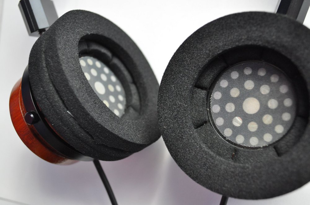

[size=small]The Mod[/size]
[size=small]For this mod you will need one pair of flat pads, a sacrificial pair of bowls, a really sharp knife and some double sided sticky tape. Age of the pads is not a problem, as long as the back side of the bowls is still in good shape since that is the side that will be touching your head (generally when they deteriorate it is the inner bowl part that goes).[/size]
[size=small]Put the bowls somewhere that you can swing the knife without doing any undue damage to anything important, and carefully cut along the line where the dense foam that makes up the back part meets the inner softer foam, as in the pic...[/size]
[size=small]I found it easiest using a sharp kitchen knife, and putting the pads flat on a chopping board, then slicing sideways with my free hand flat on the top to stop it moving. Be patient and you should end up with a neat(ish) circle of dense foam. Set aside and repeat with the other bowl.[/size]
[size=small]Take your sticky tape, and cut out a bunch of little squares and place at regular intervals on the cut side of the foam circles you just created. Once you have peeled off all the backing paper, carefully line them up on the front side of your flat pads and press down firmly. Slip them onto your favourite Grado headphones and have a listen.[/size]

[size=small]I was hoping to get the bass of flats, more sense of space, more like bowls with oomph, and I think I've managed it. Bowls still sound a thin and weak directly after either of the pads I've compared here, although if one comes to them fresh the lack of bass doesn't manifest itself so much. I don't really have a 'neutral' headphone to line up against these, but I know what I like and these are it. They don't win out on all counts, for absolute bass slam the flats are still king, but these modified pads don't lag behind very far. To me the added separation, and more three dimensional sound/headstage more than make up for it.[/size]
[size=small]Hopefully I have managed to convey a sense of what these pads do for the Grado sound, and would be interested if anyone else who is mad enough to try them finds similar results.[/size]

I think i have, at least on my older RS1s, the newer RS1is might be voiced better with bowls but I've not heard them.
Comparing these to taped bowls is closer than stock bowls, but the taped bowls are still thinner and slightly hollow sounding.  Separation and imaging seems to be about the same to my ears, but they're about the same thickness so one would expect that to be the case.  Now I just need to make them look pretty...
