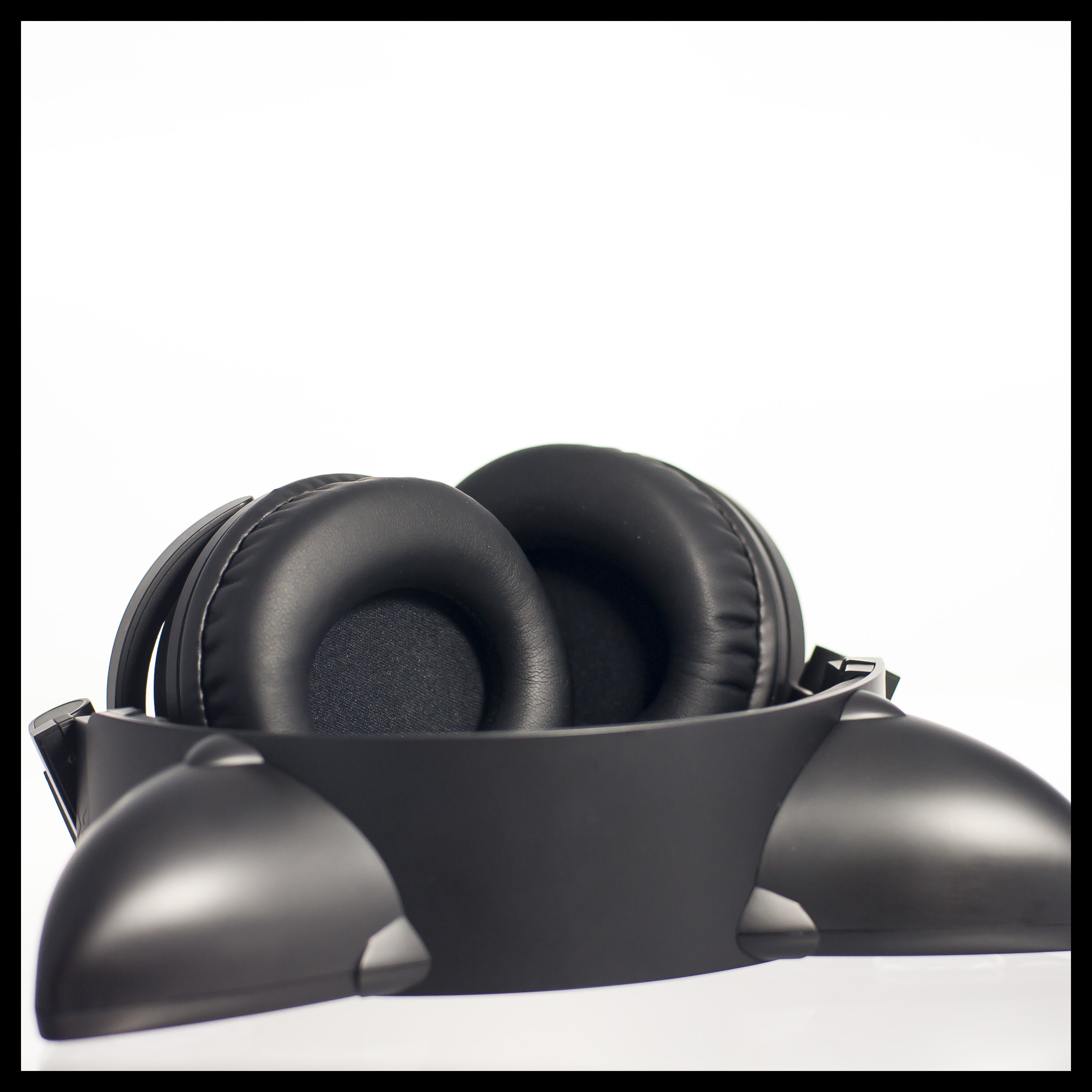

                  :smiley_cat: Axent Wear Cat Ear Headphones :smiley_cat:
[size=17.03px]           A set of fashion headphones with loudspeaker-ears and coloured lights[/size]
[size=17.03px]Disclaimer[/size][size=17.03px]:[/size]
A friend of mine purchased these in the original indiegogo crowd-fund after I jokingly posted it to them.
Upon arrival it was clear the headphone had some sonic flaws, and I was more than happy to oblige in remedying them.
Build and Ergonomics:
The entire headphone seems to be built out of plastic, at least the only visible parts, and they're all screwed together.
The black plastic is matte with a matte texture, while the purple is glossy with a smooth texture.
The cups can be folded for storage, but the storage case itself is enormous. It looks like a large shoe-box:

Modification:
First I needed to assess the issues with the design of this headphone, and address them individually.
(click on photos to enlarge)
The first problem that immediately presents itself is the space in the cups are taken up
[size=inherit]largely by the control electronics, predominantly in the right ear cup.[/size]
This presents another issue - I don't want to accidentally discharge any static around
this area, especially since most common damping materials can very quickly and
easily build up a high voltage.
The driver here clearly shows two major problems.
Two of the vent holes are completely uncovered/un-damped.
This is largely where the overpowering bass comes from.
Just a quick photo of the inside of the left cup showing the difference in size of the
PCBs in both
This shows the 2nd major flaw with this headphone.
There is a huge gap between the baffle and the cup even with the ear pads on.
If you enlarge the photo you can see I have filled this gap with thick fuzzy felt.
If this felt was not here, I would be able to take a photo ALL THE WAY through,
and with a light on the other side, it would be visible just how much sound and air can
get in and out of this gap.
Here are the mods:
• Both rear driver vents are damped with micropore tape.
• Two baffle vents (face side) are given extra damping with micropore tape.
• Baffle is mass-loaded with a few 1cm squares of sorbothane
• Fairly thick square of gauze/rolled-cotton sits directly behind the driver.
• (not in photo) thin plastic between cotton and PBCs to shield from static.
• 5mm felt around the inner circumference of the cups to seal the gap (in above pic)
  - See pics with felt not present for comparison.
