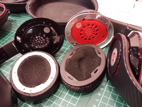

Well since the headphones run from 2 x AAA in parallel, then obviously it needs 3 Volts to operate.
Regarding the disassembly; first remove the ear cushions then unscrew the only three screws visible:
Then connect up the battery compartment to the headphone jack PCB here:
I only have the retail version, so I don't know what the demo version looks like on the inside. Care to share with us some pictures?

I took them mostly apart.  I could tell the usb connector was missing entirely.  The side I opened looked to have a spot for a square battery, but no battery.  I'd have to add the battery and the charging circuit.  I really don't want to break a functional set of Studios, so I think they're tethered to my desktop computer for now.  If I broke them trying to liberate them from the power cord, I'd be more upset.
Listening to them right now.  Sound great!  Those speakers look like they're out of a gumball machine.  I'm surprised they sound so good.
