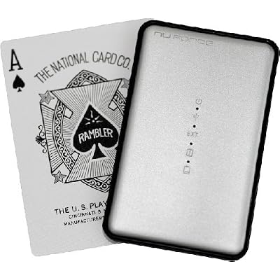

The Nuforce Icon Mobile is a $99 entry level portable USB DAC/Amp, which has more of a flat form factor that is amenable to being stacked under an iPod without adding too much size to the overall package. It is about the same width and depth as the iBasso D2 Boa, but almost half as tall/thick, so you can almost stack two Icon Mobile on top of each other to achieve the thickness of one D2 Boa. When plugged into the Macbook's USB port the DAC shows up as a "C-Media USB Headphone Set". The Nuforce has some unique features including two headphone out jacks which switch on the power when a headphone plug is inserted, with the jack closer the center being a special jack that works with 4-conductor headsets with stereo headphones and a built-in microphone, like the Nuforce NE-7M iPhone IEM (or other iPhone IEM). This allows the NE-7M to be used as a headset with telephony applications, instant messaging and Skype, and probably for gaming as well. I have not been able to test this telephony feature, but the mic did show up in my Mac's Audio MIDI setup application as the left channel only microphone. The analog input is on the same end of the amp as the two outputs (we'll call it the top end), and all three jacks are slightly recessed by about 0.5 mm along one edge of the amp.
All my portable headphones worked fine with the slightly recessed jacks, but my full size APS V3 cabled headphones needed an adapter because the 1/8" Neutrik plugs on my APS cables are too wide and would hit the lip of the case around the jacks. Nuforce has informed me that they are already planning to make changes to the case to allow a wider variety of headphone plugs to fit, and they will make it available to early buyers who have problems - but they are not sure yet if it will be possible to use the wider Neutrik 1/8" plugs used by APS, while I know the smaller Neutrik plugs from Qables.com already fit. On one side there is a USB jack for charging and the USB DAC input, a recessed gain switch that cannot not be accidentally changed, and a rotary volume knob. The volume knob is of fairly decent quality, and in low gain it is easily usable with high sensitivity IEM at very low volumes, with channel imbalance only at the very lowest volumes. The amp is totally silent in high gain with the USB music paused and volume turned all the way up.
